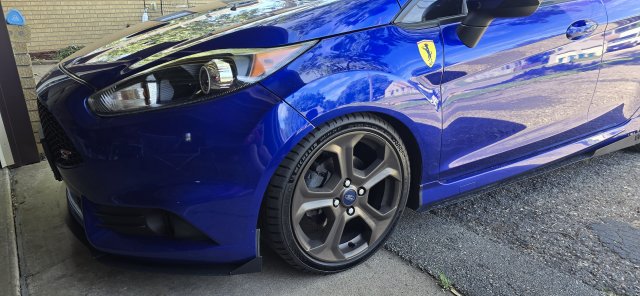

Are those the Michelin Pilot Sport 5s that just came out? If so, how do you like them?
Best summer tire I've encountered * 300 treadwear...Handle Rain...responsive...what more can you ask for? And to to it off excellent Crispy handling!

Best summer tire I've encountered * 300 treadwear...Handle Rain...responsive...what more can you ask for? Crispy handling!
Great, they're going to be my next tire. I was really glad when they came out in our OEM size. I'm especially glad to hear that they have crisp handling because that's my main goal with tires, to preserve the quick turn in of the car. That's what the OEM Potenza's had and they have long been unavailable.

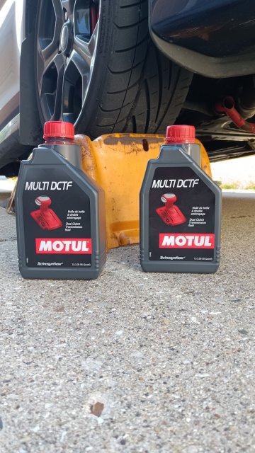

Changed the oil in the transmission. I was surprised by the difference. Not only was it smoother, but shifting was just about silent. I've always been told that dual cluch trannies were inherently noisy, so this is a nice surprise. I'd definitely recommend Motul for this car. The only hiccups were the hose I bought was a bit wider than the one used on the youtube video. I had to get a razor and slim down the width. I couldn't fit the torque wrench in the small space, the 3/8 to 1/4 adapter was the culprit.
Yup, IF Michelin ever were so kind as to release those tires in the 215/40-17 size (which is readily available in Europe/UK/etc.) here in the states, they would be on my 17x8 wheels. [wink] [mad]
Our rides have a dual mass flywheel, not a dual clutch transmission (like the problematic Ford DCT available in the base Fiestas).
Part of the confusion is that Ford specced their DCT fluid for use in BOTH our IB6 manual gearboxes, and in those ill fated DCTs, most likely to save production line co$t$ and complexities, and to ensure that those in very cold climates have smooth shifting in the winter season.
How do you like your Neo Gens in the 17" size (are they 215/40-17s or 205/40-17s??)?

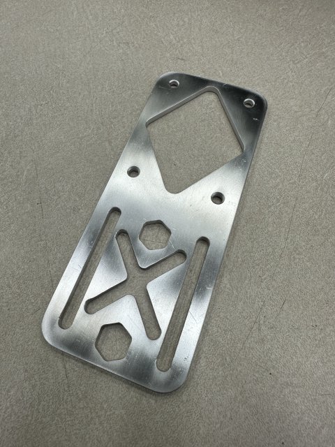

Had an open CNC at work today and a nice scrap piece of Mic 6 laying around so I decided to make a new bottom mounting plate for the Odyssey battery box I purchased. It will now be able to utilize the factory mounting locations that the stock box uses and also be able to have the ecu mounting bracket connected to it as well kinda like it would on the stock battery box. Will update with more pictures when I get home and install it. Odyssey mounting plate on left. My hack job on right.
Update
I Have to make some counterbores for one of the three bolts that mount the plate to the car to get clearance for the battery. Other than that this is going to work awesome. Have to sit the plate on a stack of 3 1/4” washers and get 3 longer bolts to replace the stock mounting bolts. Tomorrow it should be good to go. Added some pics of how it will be when its all mounted.
The tires have been great, 205/40-17. Great summer traction and decent grip in the snow. This is my second set and i'd buy them again.
