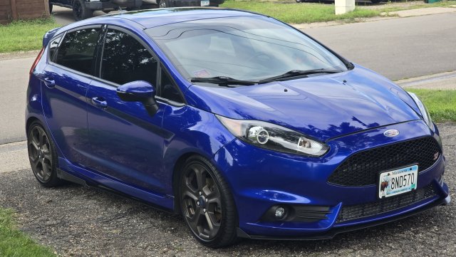

IMG_3933.jpeg Tint guy at work hooked it up with 5% tint all around, previously had 15% and wasn’t as dark to my liking, I don’t know how people have 5% on their windshield and drive at night. Anyways, washed her and slapped back the EBC Yellows as I missed the bite and chose more bite and more dust over the very low dust of the Hawk Ceramics.

Looks steller. Where'd you get the license plate hole plugs from?
I'd think it'd be easier to see out of the windshield than the sides.
I like to have the best chance of looking before I leap when turning onto dark street lined with parked cars.
EDIT: Nevmind about the plugs... https://www.amazon.com/s?k=license+plate+hole+plugs
Unlike the white, I'd have a difficult time matching the Kona Blue... maybe black or white with touch-up paint...

View attachment 63199 Tint guy at work hooked it up with 5% tint all around, previously had 15% and wasn’t as dark to my liking, I don’t know how people have 5% on their windshield and drive at night. Anyways, washed her and slapped back the EBC Yellows as I missed the bite and chose more bite and more dust over the very low dust of the Hawk Ceramics.
Need to Ditch the Yellows and Go with EBC Blue NDX* and never look back...i know i did!

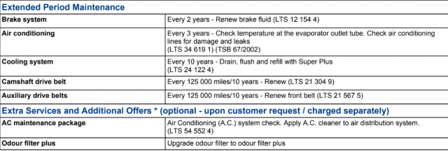

I'm attaching the European service schedule that I found. It's definitely for the 1.6L four cylinder engine. It was a few years ago, but I believe I found it on a website called Ford ETIS, which was an official Ford website which provided service and other information, and is no longer available.
Here's a screenshot of the portion of the document which recommended replacing the timing belt at 10 years, and then I'll attach the whole schedule.

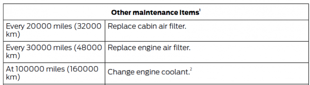

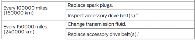

Interesting that they're specifying miles instead of kilometers. It seems they've compromised between the accessory drive belts and timing belt. Instead of one visit 100k and another at 150k, it's just one visit at 125k. Wonder if this might've been influenced by some EU consumer protection regulation?
Another difference, coolant isn't specified by distance driven; only time. Waiting ten years or 100k on a coolant change sounds like a bad idea; but I assume they know what they're doing. That said and knowing how little we get out on a coolant swap (https://www.fiestastforum.com/threa...-on-cooling-system-resolved.28344/post-474677), I'll not wait that long.
I agree. The US maintenance schedule that came in my manual specifies to change the coolant initially at 6 years or 100,000 miles, whichever comes first, and then every 3 years or 50,000 miles, whichever comes first if you look at the footnote to the part that you screenshotted .
