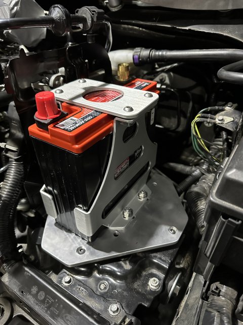

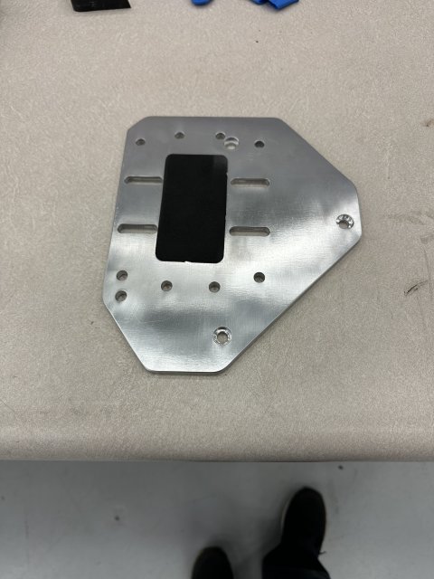

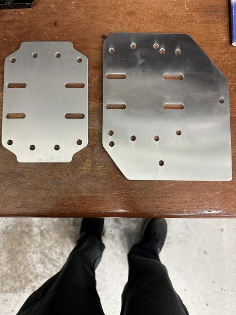

Had an open CNC at work today and a nice scrap piece of Mic 6 laying around so I decided to make a new bottom mounting plate for the Odyssey battery box I purchased. It will now be able to utilize the factory mounting locations that the stock box uses and also be able to have the ecu mounting bracket connected to it as well kinda like it would on the stock battery box. Will update with more pictures when I get home and install it. Odyssey mounting plate on left. My hack job on right.
Update
I Have to make some counterbores for one of the three bolts that mount the plate to the car to get clearance for the battery. Other than that this is going to work awesome. Have to sit the plate on a stack of 3 1/4” washers and get 3 longer bolts to replace the stock mounting bolts. Tomorrow it should be good to go. Added some pics of how it will be when its all mounted.

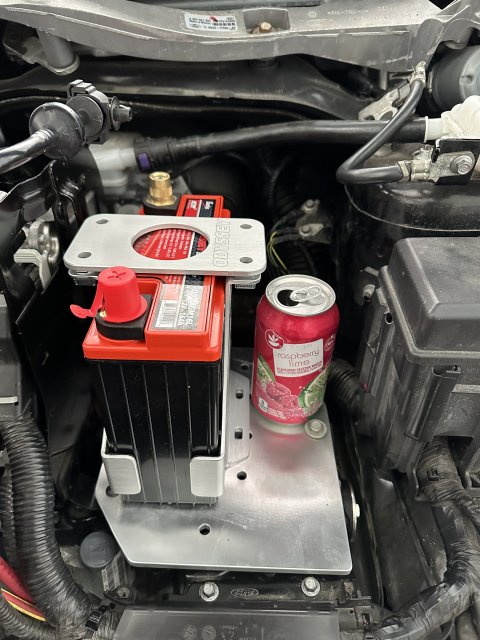

Update removed a corner from the plate to lighten it up a little and also put the counterbores in for the mounting holes. Should be good to go now.

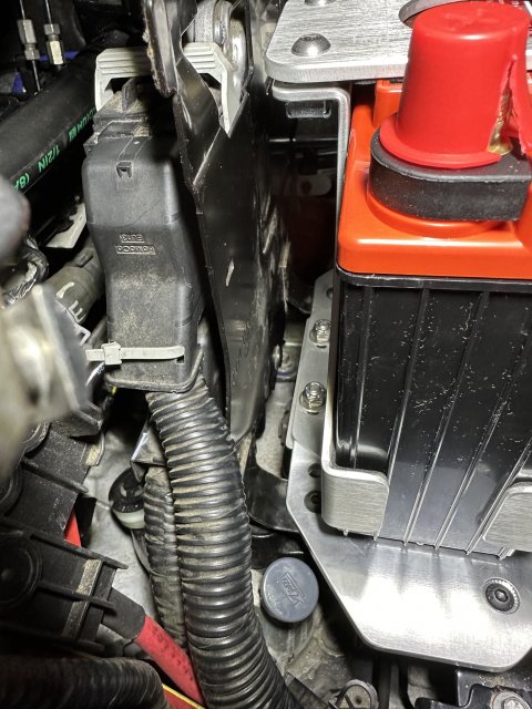

Update new battery box plate works nicely with the Odyssey battery and battery box. Definitely cleans up the bay a little.
