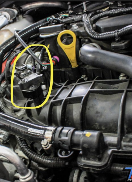

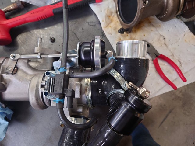

Like many others apparently I struggle to read, but the top line with a BOV just doesn't connect to anything correct? And the nipple on the BOV stays disconnected/sourced from a vacuum after the throttle body(?)
I think you’re asking about the vacuum line from the boost control solenoid. If so, yes what’s the top line in your photo can be left disconnected or you can stick a quick tap into the intake elbow to recirculate the air back through the turbo. Note the boost control solenoid has nothing whatsoever to do with the blow off valve, which you are correct connects to the MAP sensor adapter on the intake manifold.
Is there a good example of where the BOV connects to on the intake manifold? My Google searching hasn't given my any results. Can't check myself as the car isn't quite back together yet as the oil out feed fits so tight it's taking two of us trying different things to get the gasket to sit lol.

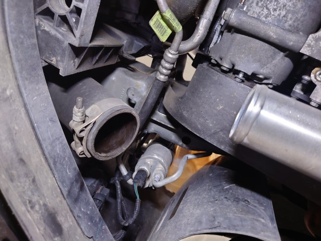

Well fuck, I didn't mind getting rid of the aftermarket hot side charge pipe no problem but I didn't realize that as a result I'd be missing a bend to actually attach the S280's charge pipe. Currently in the process of hacking up old components from the old CPe hot pipe to try and make it all fit for the moment but I need a permanent solution. Any ideas?
You have to remove the MAP sensor and install an adapter that goes between it and the intake manifold. Your kit should have come with one. The spacer has a boost reference port on it that the vacuum line goes to. If you’re looking directly at the car from the front, it’s on the top left side of the intake manifold. Can’t miss it. It’s the only sensor that has a wiring harness connection on the intake mani.
The BOV definitely did not come with an adapter, it was just itself in the box. I'm assuming that it's the Boost Reference Adapter? I got the one Ron offers for the S280 which shows one, but I definitely did not get one.
Sounds like I'm pretty boned and need to be placing an order ASAP
Correct. Did you get the kit used? Whoosh, CPE and Turbosmart all make them, as does Dizzy if you want to run a 5 bar AEM MAP sensor (not needed unless you’re going for fuel system upgrades too).
S280 kit should be 100% turn-key as far as piping goes as well.. seems like something was missing. Ron sells an S280 “s pipe” that may solve your gap problem.
Got everything from Ron brand new, the lack of pipe isn't a surprise since I had a different hot side setup already but I must have missed the strict you MUST have the stock component.
