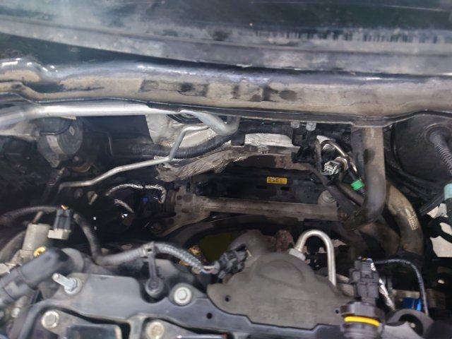

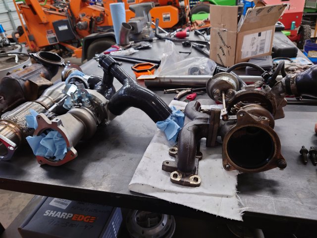

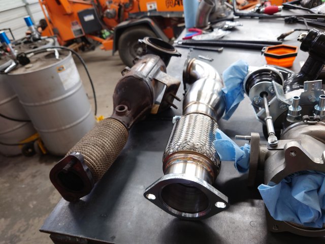

Huge pain in the ass later and the turbo is out. Definitely not a day job for me, even with tons of tools at my disposal. LSD will have to wait for another day, I'll probably ask Jason to keep it a little more moderate since I won't have the LSD to help put power down. My hope is to have it in at least a trackable configuration in the next week and a half as I have two track days coming up in the same week.
Honestly I don't know how I could have been much faster, maybe with a lift and removing the subframe. But even then so much stuff is just at an uncomfortable or weird angle it went slow since it was mostly hand tools.

Did you remove the cowl? Removed from the top?
His 2nd photo shows cowl removal. I personally disconnect the wiring harness from the three connectors shown in the picture for that bit more clearance when removing/reinstalling.
Yeah, I wanted to drop the subframe originally but came to the conclusion that it wasn't worth the effort as I don't have a lift, didn't have a complete list of discard bolts and really didn't want to fuck with an alignment again as I like how it's set up and it's just extra cost. In hindsight, the 7 ton jacks I used are really nice for being under the car (and were super nice for when I was working under there) but I'd have stuck with shorter jacks if I were to do it again. Too tall to get to stuff so I was kneeling on a scaffolding piece and honestly it just gets really old leaning on shit in your engine bay for a couple hours that is at best uncomfortable lol. That said, the hardest part was really just getting to the turbo. The actual manifold and turbo removal? One of the easiest parts of the job. Heatshield was a bitch. Coolant lines were a bitch, specifically the driver's side was a nightmare, the clip rotated 90 degrees to the left which put it facing towards the block and my 90 degree needle nose pliers just were too big to get an angle on it. Ended up using a 45 degree fuel line disconnect plier which got it loose enough to rotate back to where I could get it, then push it off onto the hard line.
Honestly my biggest problem right now is my poor job of labeling. Pretty sure I know what everything goes to. I think. Most stuff is new replacements so it's mostly the stuff I took off at the start of the day and even then most of those are hose clamps which are still attached or very obvious. But there are a couple that I am totally stumped on. So huge recommendation: Label everything at least for what part of the car it goes to.

Turbo swap on rhino ramps is the way to go. Easy to reach from the top and laying on the back from the bottom.
According to a coworker with 30+ years experience I also have bitch mitts(he has potato diggers) and the reach of Mr Fantastic. Take it for what its worth. :p
Rhino ramps probably were the way to go, but my coolant/oil catch was pretty big and I was a fool and popped my old oil filter off going through the motions of an oil change and then realized my fatal error AFTER I just let it sit halfway covered in the used oil. So I had a slow drip to catch the entire time which reduced my room (Not enough to matter, but rhino ramps would have been in the way). Ah well, for next time... hopefully not

I fold an old moving blanket and put it on top of my engine so I can comfortably lay on top of it for turbo work. Game changer.
