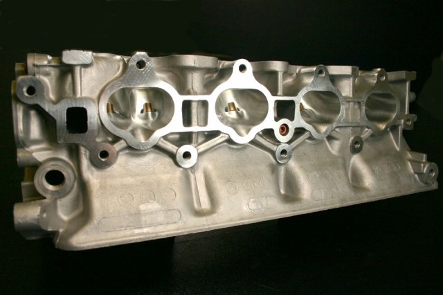

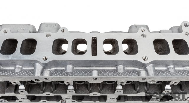

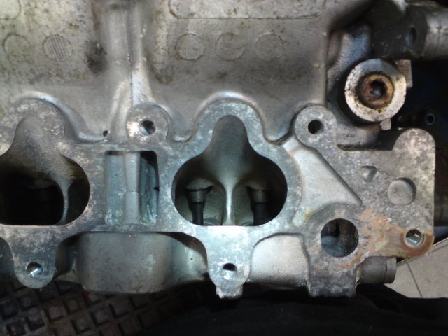

Our engines have the worst port design and flow I have seen in a while, granted it's an economy car engine. But at the same time honda had designs in the mid 1980s that out performed our modern engines. The intake port design and the head design might as well be from the 60s in the Ford 1.6 eco boost
B18B
Ported B series
This is the biggest issue with the platform imo that no one wants to talk about.

Apples to oranges comparison. The Honda stuff was designed with efficiency in mind, as a naturally aspirated engine. For the small engines they usually build, they had to do everything possible to get decent power in a small package.
As Im sure most of us know, boost is simply the turbo (or a supercharger) forcing more air into an engine than the engine can combust. Super smooth and efficient head port design doesn't really matter. As has been stated, our motors were designed as a turbo motor to begin with. Do you think the snake work of boost piping and the IC is good for smooth and easy airflow? Doesn't matter, the turbo is cramming boost through there.

It actually does matter.
It's why a B16a can make 380 crank at 14 psi
Or 507 crank at 24 psi on a 57mm turbo
Speaking of head flow. Head flow is why the B series can run a larger framed turbo (in the case from my power figure sources something just shy of G30-770) , the engine is efficient and pumps out enough air to take advantage of a bigger turbo with a similar response time us using a smaller turbo.
More cfm = exhaust gases being able to spool larger turbos.

The B series motor was not designed as a factory turbo motor. The design considerations were made with natural aspiration in mind, and for those motors, fairly high revving (especially for the time). It's not "why" you can get more power output at lower boost pressures than we run on our cars. So, will head porting help with power figures on a turbo motor? Sure. But not by that much relatively speaking, especially on a motor that was designed to be turbocharged from the factory.
So, again, apples to oranges comparison.

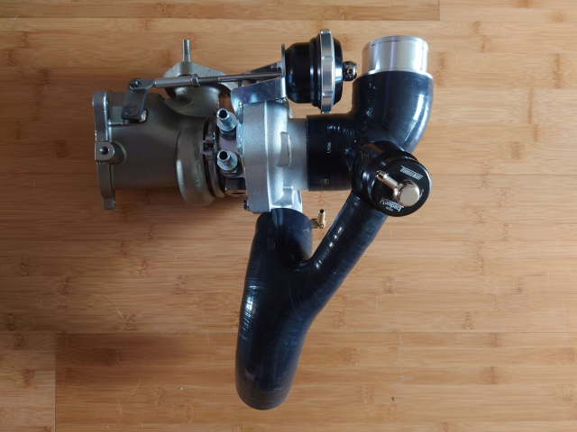

I regret to interrupt the debate, but can I get a preinstall sanity check real quick? I think I've got it set up right, but it doesn't hurt to be certain
EDIT: I did not have it set up right, I was thinking intake/outlet on the turbo side rather than the BOV's respective intake/outlet sides. Outlet into turbo intake/intake from turbo outlet makes more sense.
