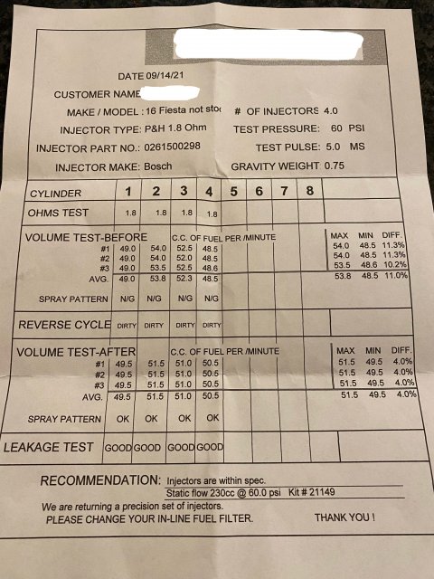

Not trying to poke the bear but as we all know our injectors run at a lot more pressure than 60psi, for cleaning purposes that is fine. Fuel Injector Calculator from WitchHunter Performance If you use this conversion chart, it will show the minimum requirements for our engines to make 200hp. To hit the 200hp mark each injector would need to flow 393.8 cc/min or 37.5 lb/hr. 49.5 cc/min=4.7 lb/hr. Even if you use the static flow of 230 cc=21.8 lb/hr that would only support about 115hp. So with out knowing the fuel pressure of the high pressure fuel pump this paper does not tell us much.

If you tested both sets together you would see a flow difference regardless of pressure.

Yes you would, but the info provided by Ron only showed one injector type and I'm not sure which one it is. As I said in another post payday which is the 1st I will be buying one of each to send to a injector service for testing. Stock HP pumps hits at least 2150 psi and the Extreme is good for at least 2900 psi. So 60 psi does not tell us much.

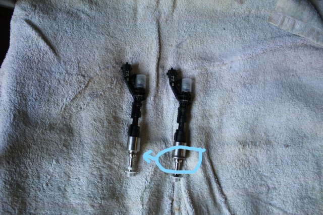

Looks like that kit would include the "tip washers" that would work. I'm not sure how else you can get them as the exploded view doesn't show separate part #s of what's included in the kit.
Maybe someone else could find them separate.
