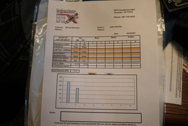

They said that they can not test at full pressure, but higher than 60psi, as hard as it's been to even find someone to test HPDI injectors, I'll take what I can get. :unsure:

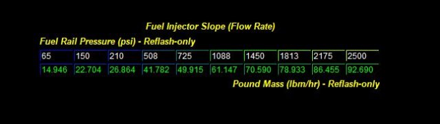

The problem is that to determine the injector slope, you need to know injector flow at various different fuel pressure points.
Giving us one value would only give us a piece of the puzzle. These are the OEM values:

Well we will see what RX can do. If we get garbage info, I will keep looking. There has to be a shop out there that can give us good numbers.

16.36 * 130% = 21.268, so the 298's are flowing more than a 30% increase than are the 337's but I doubt this test is valid at 72.5 PSI.
haste
1,222
1,267
Eastern
Yeah, the 298s are flowing 142% compared with the 337s. Your friend is correct.
