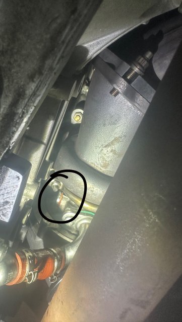

I finished my logs and sent them in yesterday. I also jacked the car up to make sure everything was ok and noticed a slight coolant leak. I didn’t smell coolant or noticed anything on the floor. I cleaned it up and started the car and I think it’s coming from the opposite side of the coolant lines where the silicone hoses go in, there’s 2 plugs with copper washers and the bottom one I think seems the one to be slightly leaking. I didn’t notice it his leak on install when I let it idle for about 30 minutes. I’m gonna check it in about a few days again. I might be able to get an Allen key in there and try to tighten it. I checked all the other connections and everything seems to be good. Anyone else had any similar problems? I really don’t want to pull the turbo out again lol IMG_1375.jpeg

I had a little bit of coolant there too, when I switched turbos. I just tightened it up and it was fine. I reused the copper washers from the original turbo as well
