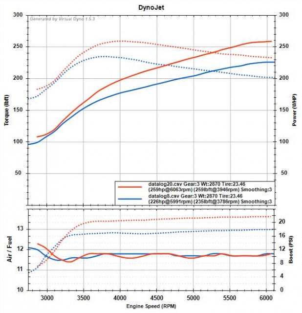

Here is my base map vs 1st revision. 15-16psi base map and 23psi 1st revision. I just got my 2nd revision back from Tune+ this morning and have yet to datalog. I doubt I will be able to today due to it being 32 degrees. I know I will struggle to get grip if its above 23psi. Hopefully my 91 tune is finished in the next week and then I can start my single port aux fuel tuning with E50. That'll be a riot.

I put the vehicle weight as 2700lbs, and me 170lbs. I do not have my rear seats in, trying to find my hatch leaks.
That is a great bump in power! Any plans to do e30?

I weighed my car on a CAT Scale today to try and be the most accurate on the Virtual Dyno. Car weighed in at 2780 with me in it. 2610 without. Car has recaros no sunroof. Rear seats and passenger seat have been taken out due to me hunting down the infamous hatch leaks. I will re install once that is fixed. Here is the fixed Virtual Dyno

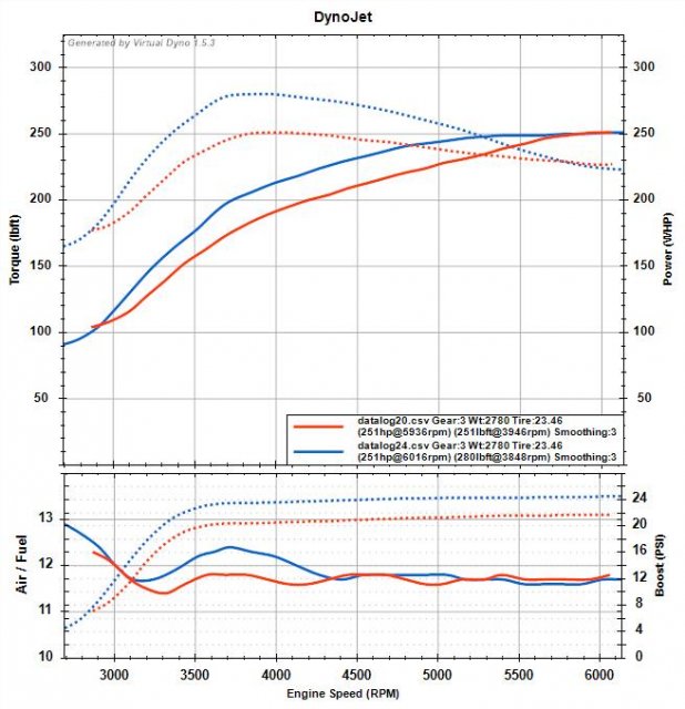

Made time to data log the 2nd revision. Weather was ok too. About 40 degrees out and my Falkin Azenis RT615k's hooked after a couple tries. They're getting low on tread.
Anyways, here is a comparison between the 1st and 2nd revision. I notice a slight AFR spike, I'm sure in the next revision it will be taken care of. Looks to have added 10-20whp and about 30wtq in the mid range which felt great in the seat.

1st Revision vs 2nd vs 3rd. If you notice the weight difference between the first 2 revisions and the 3rd is because I put my interior all back in. Added up the weight and I should be around 2710lbs, 2880 w/ me in it. One of my friends that has an S280 stock fuelling is pushing around 28-29psi and does feel a little quicker, but tuned by dizzy. I rode in it once a month ago, I could be remembering the feeling wrong and it could be right on par with hers. I'd have to actually race her to find out. Is Adam just more efficient? I notice there really isn't any timing advancements on 91 oct on my AP. It shows +1.00 of timing. When I was stock turbo I'd see that got +3 maybe higher. Guessing he wants to mitigate knock and keep it safe? Adam said this is possibly the final one, if there's another revision it'll be to clean it up overall. For daily driving this will still outrun most cars I will run into. Already ran a mk7 GTI and a Audi S3 and pulled on both. That was actually on my 1st revision, curious to see how it would stack up now against them. Aux tuning will start next week probably!
This is also at 4500ft of elevation.

what is your altitude? It plays a big role in results . I saw 284/284 on my final revision pump gas 91 and ya I am tuned by Adam and he does a pretty damn good job. I am at pretty much sea level though and you being in Arizona I am gonna guess you are a couple thousand feet higher.
Oh and ya Adam pretty much nailed it in 3 revisions on my car as well . He really knows the S280 well.
I am at 4500ft of altitude.
