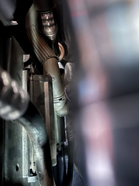

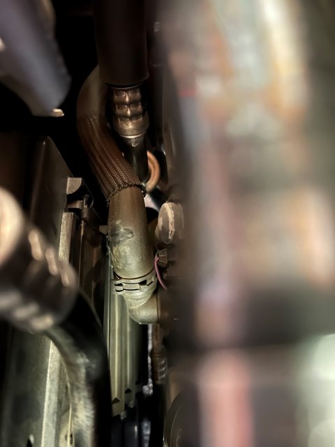

With my Mountune rad, I’ve noticed that one of the flaps on the fan shroud hits one of the AC lines. I can take a pic tomorrow. It definitely prevents the flap from opening all (even most) of the way. I don’t recall any interference with any cooling lines though.
I went in and actually looked closer at my interference, and looks like mine is also hitting a coolant line, not AC like I had thought. Given that its only a small section of the corner, I'm thinking I should be able to just clip the corner of the flap off and get clearance and not really negatively impact the effect of the flaps overall

Sounds like installer error. Never heard of a problem fitting the Mountune, or any after effects. If anything its the Mishi with the issues since its thicker and such a tight fit. As for the cooling fan flaps. I just removed all of those when I had the cooling fan out.
I would second advice to not modify the flaps. They aren’t just there to allow more airflow when the car is moving at higher speeds. They need to seal off so the fan pulls air through the radiator core at low speeds. If the flaps are removed, the fan mostly will just suck hot air in from the engine bay, as there is less resistance than pulling air through the radiator core, and your fan will simply be recirculating the hot air - your cooling performance will suffer at low speeds/ in traffic.
The core needs pressure differential to pull air through it and flaps that are suck open or absent are basically poking a hole in the low pressure area that the fan is trying to create.
Clipping a little corner off for clearance probably won’t hurt anything since it’s a small area, but removing a flap completely would be detrimental
Like I said, I appreciate the info as I understand what they do now. But too late now lol and its been fine with the 5 years that I've had the rad in my car. Even in stop and go traffic with 95+ weather it never hits above 193
