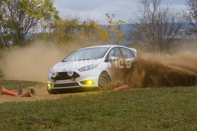

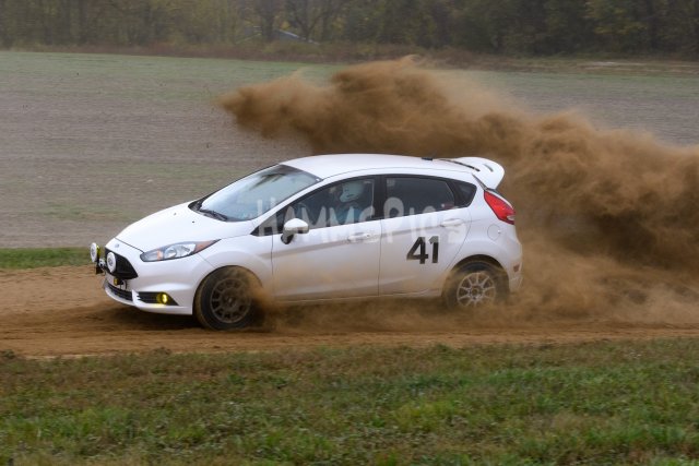

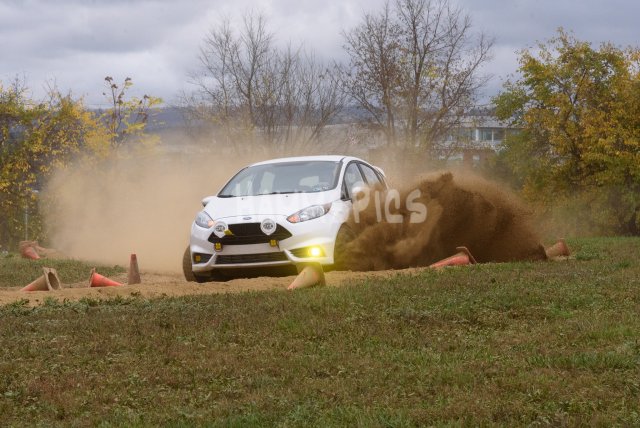

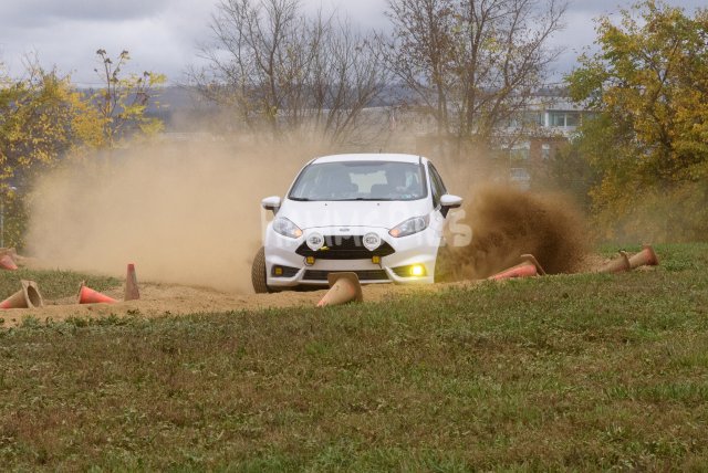

Did you fix the one foglight? Did it come disconnected from throwing all that dirt around? :D
JDG
JDG
1,863
1,995
Conshohocken, PA
Thread Starter #87
I DESTROYED a bunch of cones with that side of the bumper during one of my runs and it stopped working. Have yet to diagnose but I bet the harness broke as I did not secure it very well. It has happened once before on the opposite side LOL.

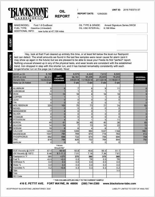

Did you get your cold start issues fixed?
The car has started up 3 days in a row (including today at 22F) with ethanol in the tank so.... I guess? Mitch messed around with the cold start fueling a tad back before the winter and it still buggered the start a couple of times but was slightly improved. But given the consistent cold start performance as of late the problem seems to have fixed itself? I ran some Amsoil PI in a few of the pump gas fill ups so maybe that helped with a plugged injector but who knows.
Edit: It never had an issue cold starting with 93 octane in the tank so this was always an ethanol-only problem which seems pretty common among platforms when running full-E
