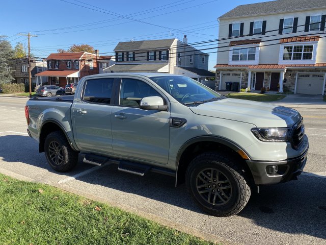

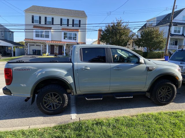

I was getting worried that when you were not on here for a while, you gave up on it, and sold it as is (or fixed it and sold it, like so many on here do).
Glad to hear you plan on fixing it and continuing on, and yeah, CONGRATS on the SWEET truck! [twothumb]
34
13
FL
Beautiful truck ! I'm also looking forward to hear any updates with the fiesta.

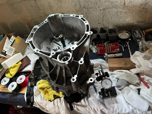

There is a Wavetrac LSD in there; almost 4 years later...
My end float measurement is .07mm which seems a bit tight compared to my research on what people ended up with installing a Wavetrac LSD.
The factory shim measures between .45 and .55 (I mangled it pretty bad so it is hard to get a good measurement). It seems like my shim should be .21mm (.14mm preload + .07mm float) but from I can tell, most folks who installed a Wavetrac went with a .30mm shim. I reused the race on the geared side of the transmission because it showed no wear but given my tight measurements, I am contemplating installing a new race and taking the measurements again.
