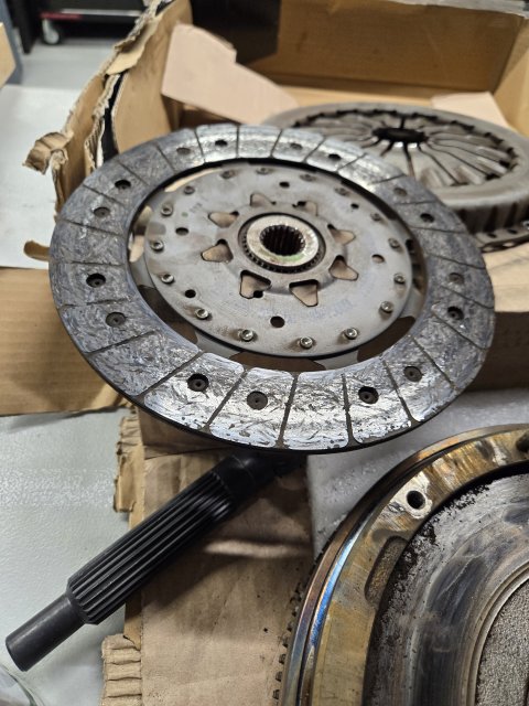

I bought a very lightly used Spec aluminum flywheel (SMF) and Stage 2 clutch (sprung) from a forum member some time ago at less than half price, just in case I wanted to play around with a lightweight SMF setup in the future. Did some research and found that people are divided into two groups regarding LW SMFs; ones that love it and others that hate it for street driving and/or had transmission issues soon after the swap. I even have friends that are brothers and one of them loves his LW SMF setup, while the other dislikes it.
Anyhow, I was practicing flat foot shifting and must've messed up badly as, instead of accelerating faster while maintaining boost, I felt the clutching slipping badly with a nasty burning clutch smell. The clutch seemed mostly OK after cooling off, but I noticed later that it started to slip when boosting in higher gears. Upgrading tires just exasperated the issue. Since I was on a borrowed time, I took this as a sign to try the LW SMF setup to further enhance that "go-kart" feeling. The plan was that, if I ended up hating it, swap it to a new OEM DMF and clutch. If I love it but end up with transmission issues, go with a Clark rebuilt unit with carbon synchros and LSD. As I don't have a lift nor a knowledgeable second-pair of hands to assist me, I outsourced the job to my friends with a shop and lift while I was on a vacation. I heard about bad experiences with new OEM slave cylinders so decided to go with the RTS CSC unit and also swapped out the old axle seals that were sweeping fluid.
First driving impression was great. New clutch feels a little “grabbier” than stock, but otherwise, was easy to operate. Throttle response was noticeably improved on the acceleration, and engine stops spinning quicker when I turned the ignition off. My friends' friend was also there, so I asked him to do a test drive to get his opinion, and his impression was the same as mine. I had to get wheels realigned as the 4-point brace and LCAs had to be disconnected from spindles as part of the job. Even the alignment tech (who didn't know about the FW swap), who remembered the car from previous alignments, commented on how it seems to take off quicker now. I told him about the FW swap and asked him if the clutch was harder to operate, and he didn't even noticed it. Added bonus is that this shaves off about 13 pounds from the front on a front-heavy car.
I have AWR PSMM and TMM, and Cobb RMM, along with stiffer bushings for about everything, so the car has more vibration than stock. Maybe because I'm NVH insensitive but I didn't feel any extra vibration or noise after the swap. The rev-hang kept the RPM up between shifts and shifting felt the same as before the swap. I will post updates here if I notice something else or an issue develops later. The next plan is to upgrade the HPFP and injectors to go E50+ once I run out of WMI mixture to max out the stock block and see if Spec Stage 2 clutch can handle it.
Below are pictures of the old flywheel, clutch, and pressure plate. They looked about as bad as I pictured them to be.

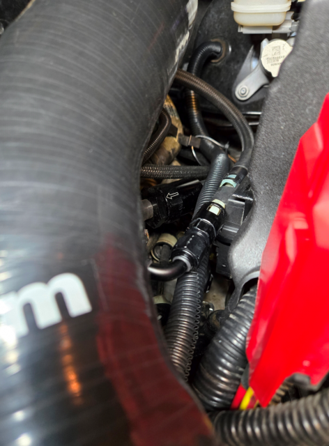

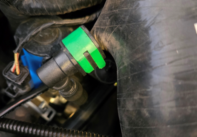

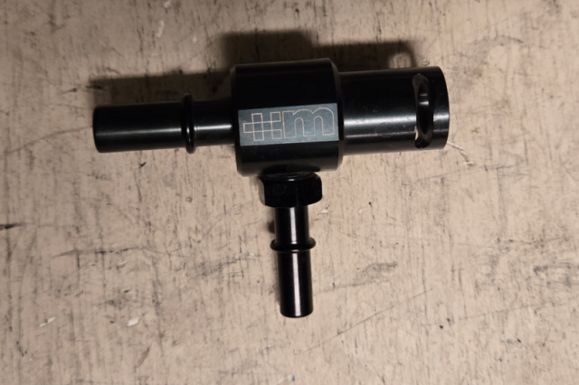

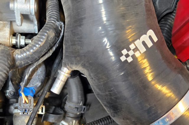

The car recently started throwing code for a evap system small leak. I'm not too surprised as I reused the OEM tubing using a heat gun when I replaced the purge valve a while back, which likely loosened up enough to cause a small leak. My original plan was to replace the tubing with silicon hoses but I wanted to do an experiment with it first.
Replaced the firewall to purge valve tubing.
Intake manifold to check valve was the only portion that I kept, to prevent the system from getting pressurized during boost.
I ran the hose straight to the purge valve, getting rid of the T fitting and tubing that goes to the induction hose.
I also removed the tubing that goes from the cold-side pipe to the induction hose. I have a 2016+ style Mountune induction hose, but removing the "T" piece in the picture below turned it into a 2014-15 style means only one port to cap.
Also capped the port on the cold-side pipe. I added a fuel line clamp to make sure it stays put as this cap will experience boost pressure.
Pros:
  • Reduces engine bay clutter
  • Less points of failure
  • Eliminates a small boost leak (by design) from the cold-side pipe to induction hose
Con:
  • Purge function will not work while under boost
Since I don't drive in conditions that require extended boosting (e.g. racing or hill climbs), I am hoping that I can avoid triggering any codes with this mod. Nevertheless, I ordered some 3/8" ID check valves to build a 2014-15 style harness if I do run into issues. I have 25 miles so far (also did some max boost runs as a test) on this mod and no issues so far, will post an update if something goes sideways.

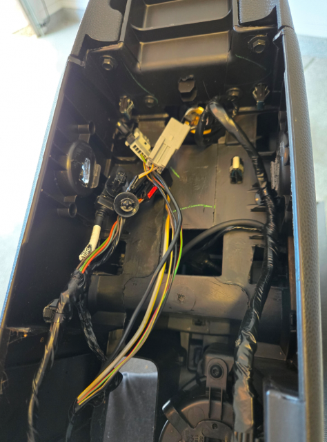

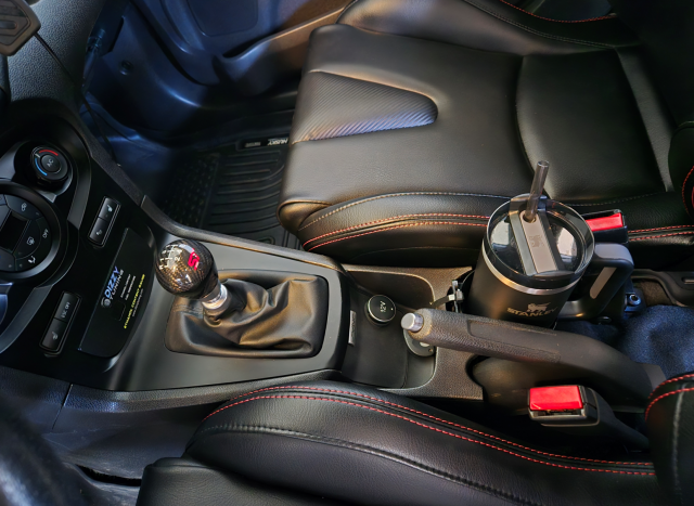

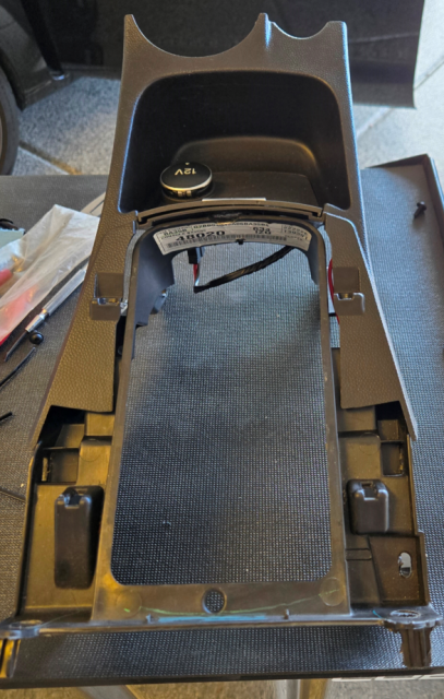

Since I don't use the arm rest and anything taller than a regular can in the cup holder gets in the way, I performed a half console delete, similar to what shawn36 did. This should save about 10 pounds.
This is the front half.
Kept the front power portion functional by unpinning two wires for the rear port.
Underside of the deleted rear console

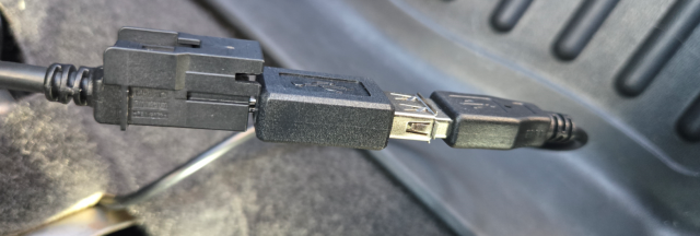

Turns out that USB hub will not work without the separate power connection. Since I only use one connection, a mini-USB to type-A adaptor did the trick to get Android Play working again
I ziptied a large cup holder to the front portion of the console. As you can see below, it can handle larger bottles like a champ.

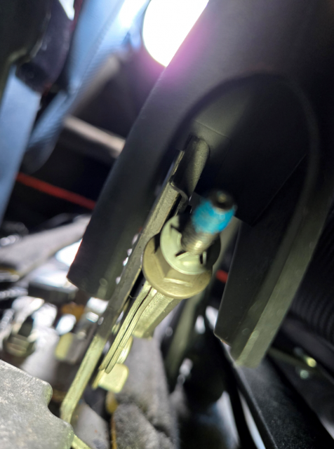

Parking brake handle always felt loose even though it only had about 40K miles when I bough the car. I adjusted the nut while I had the console out and it feels much better. 2-3 clicks are plenty enough for parking now.

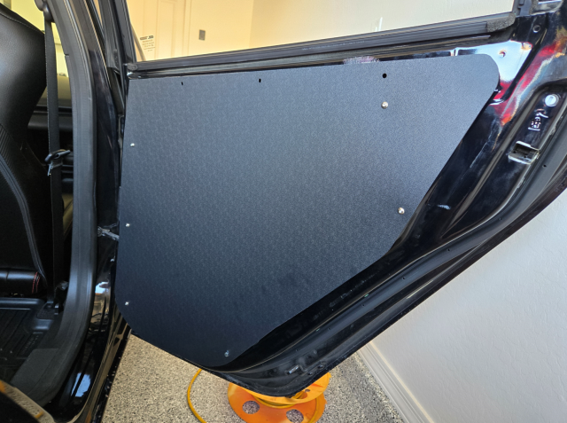

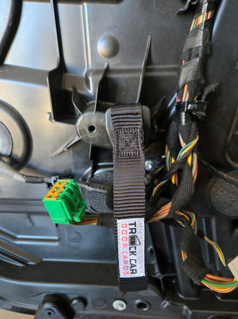

To further the go kart theme, I install a set of door cards from Track Car Door Cards. OEM door cards weighed 10.7 lbs on the bathroom scale. Track door cards were too light to be weighed by themselves, so weighted with the OEM ones. They came out to 13.2 lbs combined, so 2.5 lbs accounts for the track ones for overall weight savings about 7.5 lbs.
I chose the option for the pilot and speaker holes. The European setup may be slightly different, because while the shape of the door card was correct, about half of the pilot holes didn't to line with existing clip or bolt holes. There also were holes for tweeters so I drilled a hole for them and other existing mounting points. Extra holes don't bug me but I can always cover them with short screws (to make it look like they are in use) or use something like black RTV to fill them later.
There is definitely more room now was I can spread my leg without touching the door now. I image track cars use these to make room for roll cages.
There is one part I had to cut off of the OEM inner card to keep the track one mostly flat.
I reused the screw from the OEM door handle for the door strap.

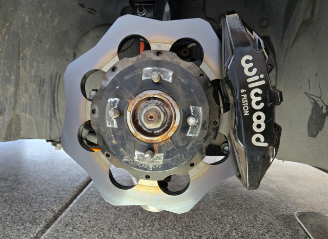

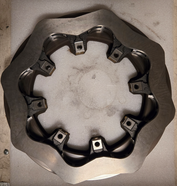

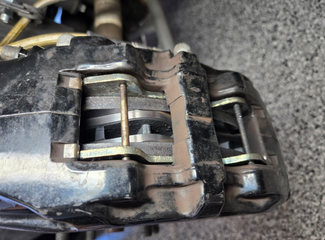

I started experimenting with scalloped brake rotor rings in an effort to shed more weight. Per Wilwood's site, BBK rotor rings weigh 8.9 lbs each, whereas scalloped ones are 5.9 lbs each, for weight savings of 6 lbs of rotational and unsprung weight per pair.
The main drawback is that lighter rotors heat up faster. I hoping I can get away with existing weight reduction mods, which means less mass to slow down. I also swapped the pads to BP-20 along with a recent brake fluid flush with DOT 5.1 fluid to handle the additional heat. As a part of the pad bedding process, I preformed eight hard stops from 65 to 25 MPH and felt that brakes were still effective after the 8th try.
After driving for about 20 miles the next day, I took the wheels off for better visual inspection, and also to bleed the brakes as an extra precaution. Both the brake and fluid looked fine to me. If anything, it seems like less brake pedal pressure is need, probably due to the upgraded pad compound and less rotational mass. Front end seems to be a little bit more responsive now, similar to when I upgraded to lighter wheels.
Two rotor rings stacked on top of each other for comparison.
Mounted.
Mounted with the wheel.
After the bedding process.
Closer look of how pads look sitting against the rotor.

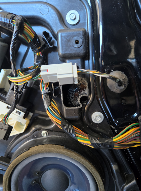

Driver's side track door card buldged out a bit because the bottom of the stock window switch is rather large for the tight space. Since power windows for rear are no more, I found a new switch for 2-door EcoSports (SW-7316) on eBay for $30 to swap in. It has the same shape on the top, but the bottom is only half the size.
It sits nice and flush with the track door card.

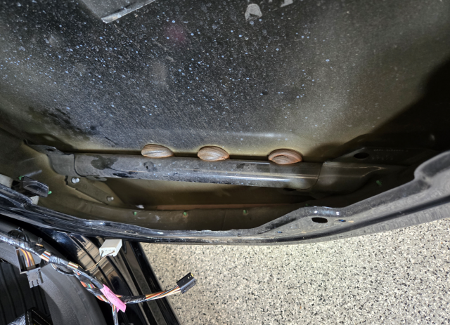

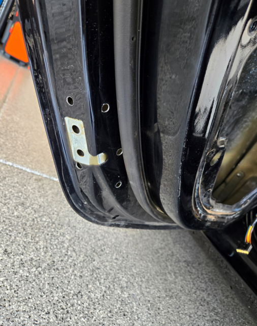

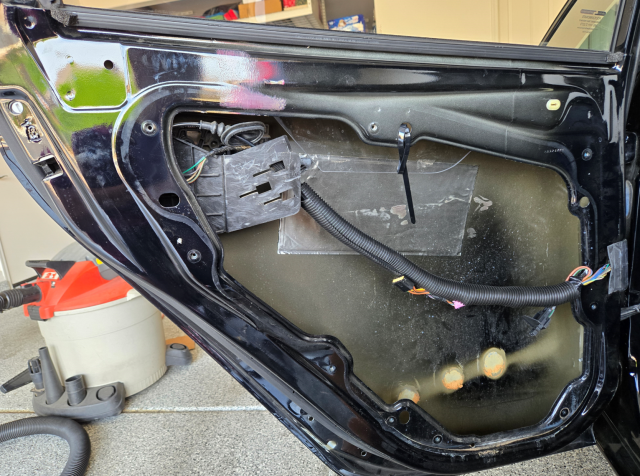

Decided to go for additional weight reduction by finishing the gutting of rear doors. Inner door cards with attached window regulators and side impact beams came out to 13.9 lbs for both sides. The previous rear door weight reduction (Lexan windows and OEM door card, power window motor, and speaker delete) come out to 26.4 lbs, for total of 40.3 lbs in weight savings. Something to consider if you're doing the rear seat delete.
The side impact beam before the removal.
Needed to drill out the four welds on one side (I didn't drill through the door, placed a cardboard in the back to protect the outer door skin while drilling).
Two bolts and five welds on the other side. I put Gorilla tape over the holes, similar to how I used it to replace failing body tapes when I had the rear bumper off.
Rear Lexan windows have 4mm thickness along with the hard coating so they fit tightly in the window. Thus, they stay up even without the window regulators, but I needed something to keep them from sliding down due to the vibrations. I was thinking about drilling a hole for bolts/nuts, but saw that there was an existing hole near bottom of the window, which happens to be near an existing hole in the door. So I just used a zip tie which held up well so far. I also put the wiring and unused connectors in a loom to prevent them from flapping around and making noise.
Track door card can now be installed flat against the door with the inner door card gone.
