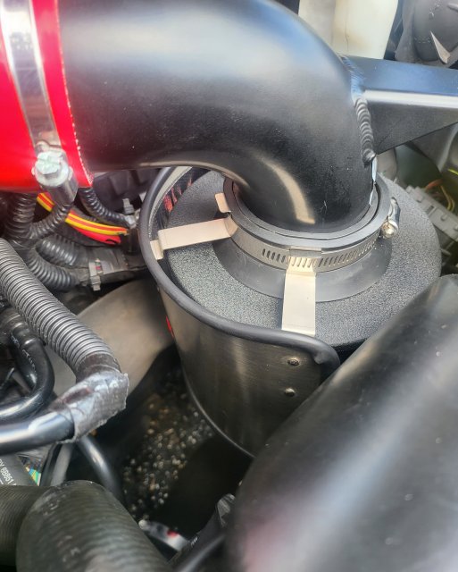

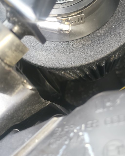

So in an effort to combat heat soak with the pro alloy intake I did 2 things, the first which helped immensely with bringing temps back down to about 10-15 degrees ambient was using the stock air box snorkel. I simply shaved the opening about an inch or so to allow space, which now sits directly in front of the filter providing much needed cool air. The 2nd I just wrapped up is a heat shield by AFE. Had to remove the mounting bracket for the stock air box and it fits perfectly inside now. Intake temps are now within 10 degrees ambient while driving. And recovering from much higher very quickly after long stops. Next up is the big mouth for cooler air.

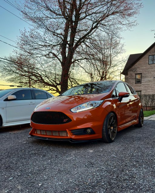

Wasn't today, but this past Saturday.
Installed Depo Euro headlights and ITG intake. I installed the headlights the lazy way without adding the additional fuse to make the DRLs run proper, but will tackle that part of the install another time. Just ran out of time that day.
Looks good, are you the same guy selling the wheels on FB. If so I can’t believe how many people were jumping down your throat for the verbiage used. Lol sheesh!
