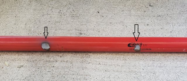

Fixed the creaking and rubbing issue of the Versus rear diffuser. The mounting height was the culprit. I couldn't figure out the actual rubbing point (turns out it was on the rear anti-sway bar) until we actually took the rear anti-sway bar off. I didn't figure it out until then because they were so close together that it was impossible to see between them without doing that. Did that today with lots of help. The three bolts that mount the diffuser to the single bracket next to the anti-sway bar were clipping it badly going over speed bumps, driveways, or just leaving my garage. You can clearly see, in the second photo, where the driver side and the middle bolt clipped and dug into the sway bar every time they passed by each other. When the car is up on jacks (the only way to I could see under the car) the mounting point is much higher than the resting height while it's on the ground. I didn't know that at the time.
The third bolt (closest to the passenger side) was just....gone. Our best guess is it completely sheared off at some point (red arrow). The other two bolts were still on tight....although I couldn't take them off with the Allen key, as they rubbed down so much that the hole was totally deformed. After we got those off, we pushed the diffuser as high as it would mount. Also, mounting the diffuser on the rear of the bracket, as opposed to the front of the bracket, in order to give just another mm or two extra clearance for the bolts to be away from the sway bar. Now the bolts are much higher and away from the sway bar as you can see the difference between the red line and the yellow line. Took it out for a test drive. Quiet as a quarantined church mouse. Thank God that's dealt with and over. Can't wait for my Vega front splitter to show up!
I'll need a little touch up paint.....

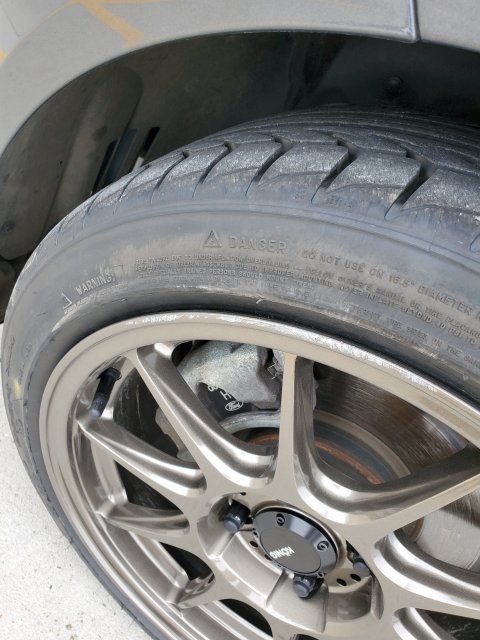

Just glad I didnt pop for something more expensive or hard to find at this point. I will order up another from Enjoku this week then I have a spare or a "community" spare that I sell to someone for a deal thats in a pinch.
If this would have been a Compmo or a Braid, or even Speedline I would be having a coronary right now.
Still can't believe I did it. I heard the noise and knew I was not going to be happy.
Yeah, that's one of the reasons (among others) I ordered my second set of Dekas today from DTD (along with the A052s, and I got an extra $200.00 off of everything, because; flash sale and customer satisfaction discount).
The Braids I wanted were MORE THAN 3 times the cost of the Dekas, as well as being ~3.5 lbs. heavier each (and the Speedlines almost 5 lbs. heavier each despite only being 16x7s!), and the spokes bow out a bit (a la 17"1.2s) so they are even more susceptible to damage there, vs. the more set-in spokes of the Dekas.
High price to pay for something 'different'. [wink]
I would have bought a spare for each set of Dekas (1 black, 1 bronze), but DTD would only grant that discounted price on a full set of 4, with anything under that amount sold at full list price. [:(]
