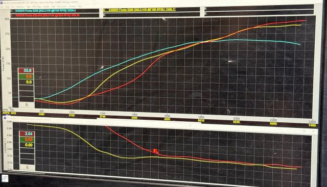

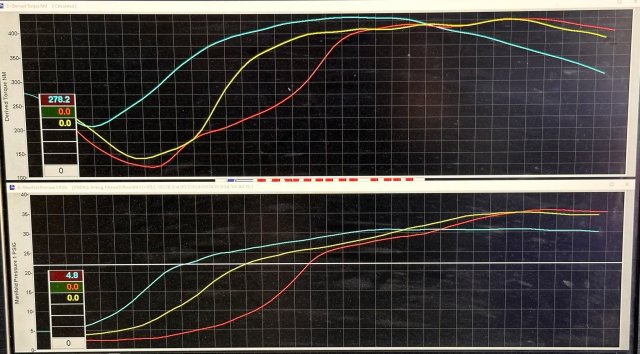

Skip the Gtx2860r, old ass ancient tech.
G25 550 has the most top end out of all the conventional turbo kits but it's also the laggiest. The S290 has a similar top end but it spools significantly sooner.
If you're looking for top end that doesn't tapper off at all...S290 is a great choice.
The G25 550 is slightly too much turbo for this car really unless you can spin more rpms. You would need a bigger cam, ported head and intake to justify running it.
Here's a graph of the powerband
Red G25 550
Yellow S290
Blue S280
As you can see, the G25 550 has an unacceptable torque dip, it's just too much. The S290 remains flat till the end.
Team NDR used to run the G25 550, when they switched to the S290 they actually got faster because it spools 1000 rpms sooner than the G25 550.
People need to do research instead of just running off of a dogmatic opinion from the cult following of the S280.
I plan on buying it soon myself.
Hope this helps.
