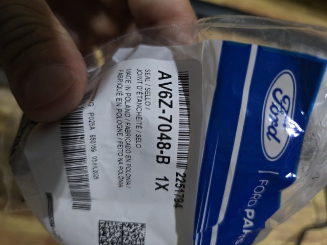

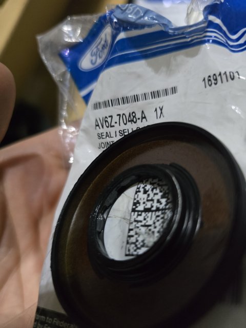

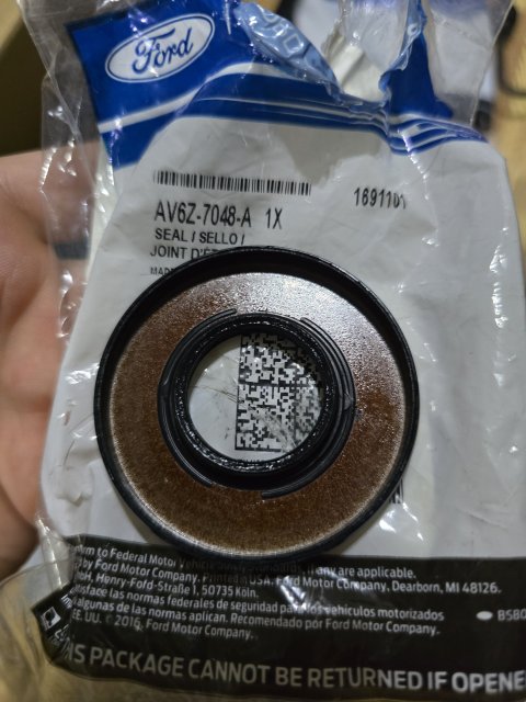

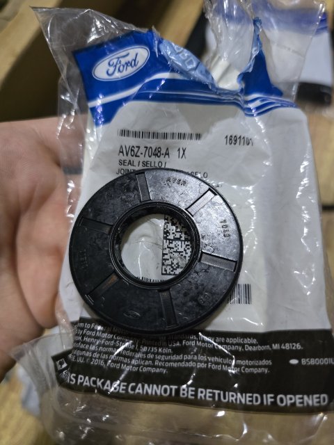

I found an updated part number for the input shaft seal. Was wondering if anyone knew what the difference is and whether it'll work with the older model years? The A part says compatible up to 2017 and the B part says it's compatible with 2018-19
AV6Z-7048-A
AV6Z-7048-B
Tascaparts says the B part# won't fit my 2014

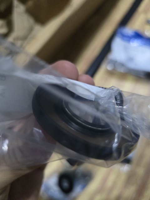

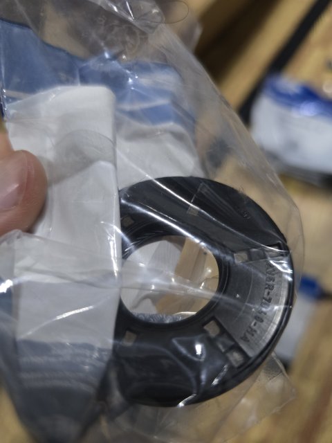

Just got both parts. There is a definitely a difference so I assume the newer part # is improved. The newer part(AV6Z-7048-B) has an extended groove inside the circle
