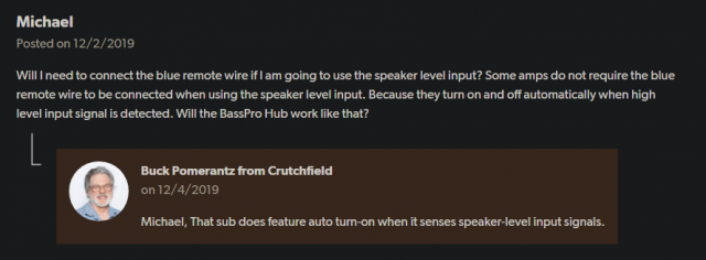

For the remote turn on, I'd think you'd need something coming from the head unit and that's the part I'm least sure about. I think I've heard that people splice into the rear speaker for that since it's close and would be pretty easy. Can anyone confirm?
Saw these on Crutchfield. Answer your question?

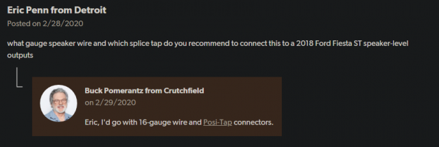

huh. So for the remote turn on I just need to splice it into the correct wire in the under the dash or fusebox (but do we even need to do that? It looks like it has an auto turn-on when it senses speaker input) and for the audio itself plug the RCA from the sub into a PAC adaptor which splices into the wires below? Since it's mono it doesn't need a speaker from each side?
Right Rear Speaker Positive Wire (+): Brown/White to PAC Grey & White.
Right Rear Speaker Negative Wire (-): Brown/Blue to PAC Black/Grey & Black/White

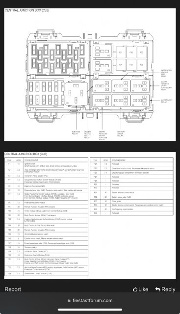

Hey guys. So the fuse will be connected to F35 roof opening? To start and stop the subwoofer automatically?
Realizing that the USB module turns on/off with the radio, I decided to utilize that as the remote turn-on signal.
https://www.fiestastforum.com/threads/guide-amp-remote-turn-on-relay-12v-outlets.29095/

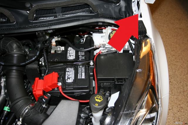

I also avoided the firewall route for my power wire, feeding it instead via the fender. I suspect the fender route was meant for some accessory such as heated mirror.
