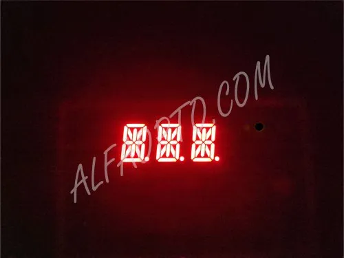

I remember the old 1980s LED displays (and watches) that would have random bars that went missing. Had to take them apart and cleanup the contacts between the PCB and LED panel. Often the silicon/rubber conductive pads were the culprit, if not the mountings that held it all in place.
Modern LEDs are of course constructed differently and are more reliable. But they're not infallible. You may just have a failing display -or- failing solder joints on the PCB that need to be touched up. If it is just failing solder joints and you can get to them, that's an easy fix. "Silver bearing" solder is the easiest to use; and is very reliable because it still contains a small amount of lead.
