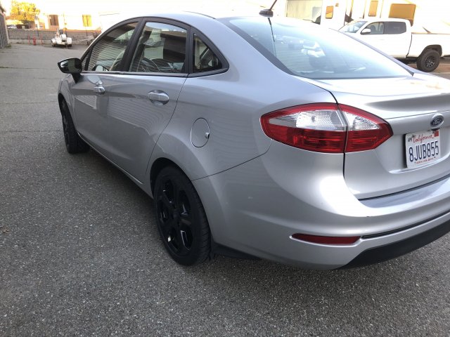

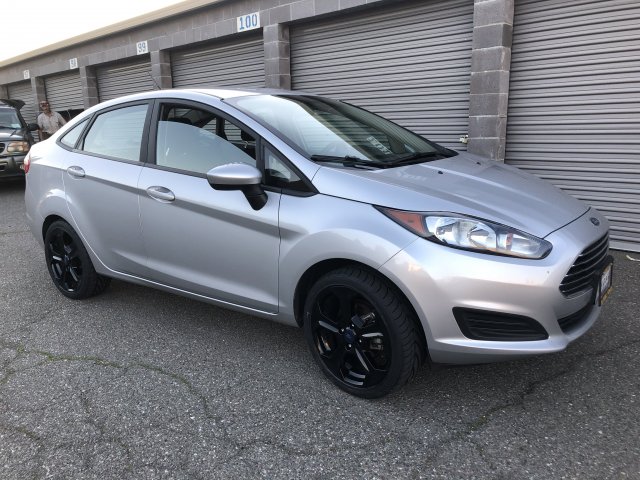

So here's a report back after running the Nitto Neo Gen tires for a month and change in 215/40R17. Note that unlike my original post I went with a 40 series tire instead of 45. From the standpoint of eliminating tire gap I wish I would have gone with 45 series, however from a gear ratio standpoint, I'm glad I went 40. Note this is a non-turbo S model car that next month will get ST springs and Bilstein B6 shocks front and rear, so it may be a half inch lower in the future. Right now I've just got a back Eibach sway bar, and due to the softer S springs, 2019's came from the factory with a thicker front sway bar than an ST: 21 mm vs 19 mm. I've measured my front and it's 21 mm. Car handles very nicely, I've not found the limit yet on the street. The Neo Gens are nice and quiet, great rating there. Great ride, not harsh at all. Driven in some heavy rain and took quite deep water to hydroplane. Got them Road Force balanced on the Hunter Elite machine at America's Tire and they're smooth sailing at 80+. Would highly recommend this tire for street performance handling.
