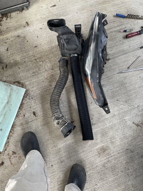

Something about the way the I’ve got the ST200 intake plumbed up (brake duct to a bell mouth in the front fog light space, enclosed by the skid plate) plus the velossatech big mouth seems to produce an extremely loud high pitched suction sound. It doesn’t sound nearly that loud from the cabin. Not sure if it screams more “F-35 fighter jet” or “Dyson vacuum cleaner”. Maybe it’s crying out for a turbo upgrade or something. That or the bellmouth is too close to the bumper cover (vacuum cleaner noise)

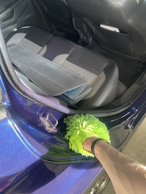

Washed up the car before the trackday. I’ve been using using a much streamlined wash method that first better with my free time. Optimum No-Rinse in a gallon of distilled water. Buff dry with microfiber and a squirt of Opti-Seal as a drying aid+protectant. Seems to work great.
Was almost done when I had an epiphany. I can wash the door jambs, door sills and the inside metal of the doors without getting the inside of the car wet. Mind Blown!

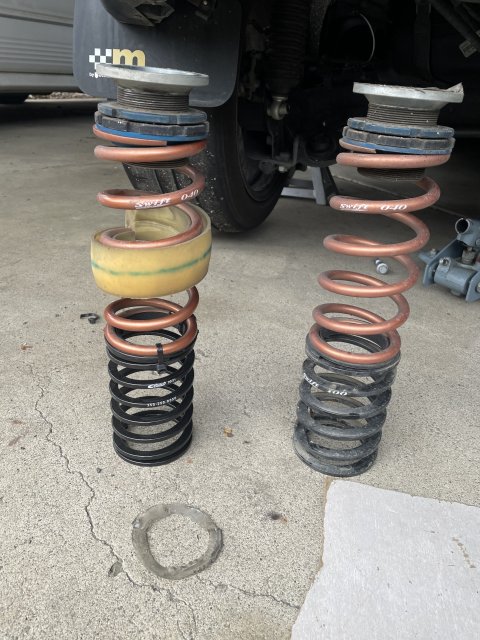

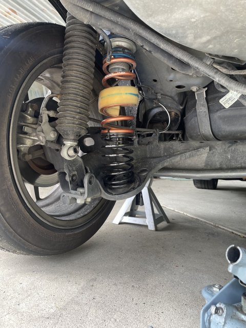

Since changing the rear springs to the coilover setup, everything has been great but I noticed that over very specific bumps, the tail felt like it was kicking up in the air. My suspicion was that my tender springs had too much preload, because I struggled to get the springs in even with the beam lowered as much as I could. Theory being that either the force profile stays too high shoving the rear in the air, or having a momentary discontinuity between force and no-force whenever there’s a brief wheel lift on rough surfaces. It also manifested itself as the car lifting the tail up quite a lot under hard braking.
To fix this, I switched out my 5” 100lb Swift tenders for some 5” 50lb Eibach tenders. Didn’t opt to stay with Swift because their 50lb tenders are 6”, requiring more compression and I was worried I’d be back where I started. Also the Eibachs had the same compressed “block height” as the Swift, so no need to readjust ride height.
Long story short, the problem seems to have gone away! Lesson learned, too much preload can affect handling, just as too little (like zero rate tenders) can.

What are you going to use as an inlet for the OEM ST 200 hose, and where will it pick up the outside air??
Mine is just sitting inside the bumper area behind the fog light currently, but eventually I want to connect it to a duct in the factory air dam/cooling aid thing at the back edge of the bumper.
Of course my Skid Plate Guy bash plate will prevent that from being used, IF I ever have reason (working ARA rallies like I used to 2-3 times a year, IF they ever again decide to hold even one in the Mid-Atlantic, or Northeast going forward :(:mad:) to install it again.
I did the same even with the bellmouth, run to the area behind the fog light which gets plenty of airflow (including from the slots in the front of the wheelwell which somehow doesn’t accumulate debris in there). I thought about cutting a hole in the insert next to the fog light, but haven’t yet decided to cut holes in the bumper, and am also now 100% convinced it will actually gain anything other than look cool

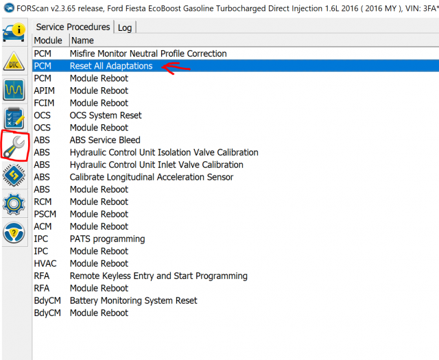

Okay, its time for one of those "I wish I knew about this before" moments
For a little while now, the steering has been a bit darty, which I chalked up to the zero toe in my latest alignment. But I've started realizing that sometimes I randomly get a pull to one side, almost like my camber is off. But it sometimes goes away, and sometimes randomly pulls in the opposite direction. Happens most often shortly after startup, but things have always felt a little squirrelly under acceleration and braking, ever since I got the car.
But, I started wondering if it was something electronic. I was searching around, and came across some random posts like this one on Ford's "adaptive learning" and something called "drift pull compensation" in EPAS steering systems.
After searching how to reset on the Fiesta it and coming up with only the Ford factory service software demos and Forscan to reset on the PSCM (power steering module) for the FoST and other cars and how you're supposed to reset it after changing your battery (for some inexplicable reason), and not figuring it out, I noticed this service procedure in Forscan, on the PCM called vaguely "Reset all adaptations". Given the centralized nature of the Fiesta control system, I guess I shouldn't be surprised.
I decided that since I've been through something like 2 battery changes, 5 suspension swaps and 8-10 different DIY alignments (including some where I didn't get things quite right and had to redo) since owning the car, that its quite possible it's learned some bad habits. And since it's an adaptive system, the worst thing that could happen is that everything gets reset, not just the steering algorithms. I decided to give it a try.
Wow. All of a sudden the steering is precise, no pulls or nervousness and the car tracks straight as an arrow on the freeway! It also seems to have reset the ECU's octane learning on the tune, and probably a bunch of other stuff, but I am one seriously pleased customer! I have another trackday coming up, and I'm REALLY looking forward to seeing how the car does, especially with the "booty shake" I was getting under heavy braking.
Be advised that an extended license purchase of Forscan is required for this service procedure (my previous year's one had expired), but so worth it, especially if you're experiencing any steering weirdness.

Interesting, so then adaptations persist somewhere in non-volatile memory and don't go away when battery is disconnected for some time? :unsure:

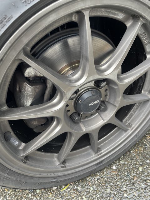

I tried out a new set of inexpensive Powerstop “Track Day Spec” brake pads in the front on fresh Centric rotors to see if that would combat the brake fade. The heat resistance ended up being only slightly better than the stock summer pads.
Unfortunately after two solid laps coming into the final hairpin of the track, friction started to fade halfway into the braking zone.
The pads were not nearly as unlivable as I was expecting from the name. At cold, a slightly weak initial stop until they grabbed, and an occasional mild squeal, but nothing like a true track oriented pad. They might be plenty adequate to track on a budget on a car with even decent summer street tires, but they’re not up to repeated braking with sticky 200TW tires.
Probably more a testament to how decent the stock pads are than a mark against the Powerstop pads. I’ll be looking into putting together a better setup before the next event. Babying the brakes definitely feels like it’s holding me back
