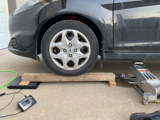

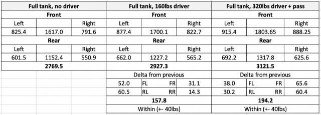

Also, I managed to get some new corner weights for the car…at the dump! Dropped off the coolant at the recycling center and they had a scale - it wasn’t busy, so the attendant let me take a couple of measurements. Managed to get the whole car, the rear axle, the right side and the right rear tire and still see the scale readout. Between those I worked out the individual weights. The scale seems like it was pretty repeatable and probably decent to 10 pounds, as they actually charge by weight for big dropoffs, as I got same value for the left front by calculating it out both ways.
Between the new brace and skidplate, the spare tire and my roadside bag in the back, a mostly full fuel tank (instead of ~1/4 like last time), and the new shocks/struts which are significantly heavier (but lower unsprung weight being inverted), the car came out 100lbs heavier than last measurement. (2940lb With 150lb me in the car). Also, somehow I lucked out with a 50.3% cross weight just by eyeballing the left front adjuster, and choosing the “slightly shorter” eBay spring in the right rear
Based on the measurements, it almost looks like I could stiffen the left side springs a bit. I think I’m going to play with some spring rubbers on the left front, and maybe go to a heavier spring or rubbers on the left rear. Making right and left frequencies more closely matched should help some of the side to side “rocking” over bumps (although the sway bars are also responsible for some of that.)
Once I have the setup close to final and the shocks back from FCM, I should probably get a “real” corner balance and alignment at a good shop, just to verify my “shade tree” alignment measurements aren’t too sloppy. Also, need to make up a real toe gauge. Two tape measures flopping all over the place is getting annoying, and setting up the string box takes a bit of time to get right, especially if adjustments need to be made
I actually just did this on mine, albeit with a different method.
Full stock interior (with recaro), full tank of gas, essentially daily driver configuration. 2014MY with sunroof. 185/60/15 winter tires with 15x6 OEM ford steelies. Koni orange dampers all around, stock 2019 springs. Stock exhaust.
Front
Whoosh v3 intercooler
Suave 4point bar
Ramair crossover pipe
Whoosh hotside pipe
Butyl 80mil sound insulation in front doors
Rear
Half-size steelie spare tire
Mishimoto rear brace
10 lbs roadside kit emergency bag (right rear of trunk)
Full trunk (but not hatch) butyl 80mil sound insulation
It's also an interesting way of seeing the difference in droop travel from the front to the rear.
Using an Amazon 660lbs package scale and with this beam method, I was able to measure with a (+-5lbs) accuracy each corner of the car.
Here is an example:
You can see that the front left corner with no driver in it is 407.1lbs. After the driver and the driver+pass measurements, the scale showed 418.0lbs, indicating a shift of 10lbs, (so +5lbs). I averaged both these results. This indicates a good +-10 lbs of potential variance for each axle (after timing the result by two, per the lever arm).
Did three measurements, empty, 160lbs driver and 160lbs driver + 160lbs passenger. Here are my results. You should apply a +-10lbs measurement interval for each corner, and in total, a +-40lbs interval for the total weight.
The beam method is not as accurate, but it seems that my measurements are in the ballpark of your yours. The only notable difference would be the left front & rear distributions.

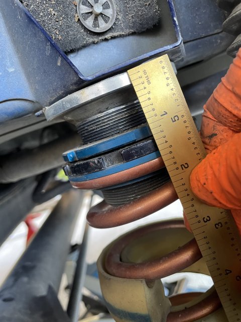

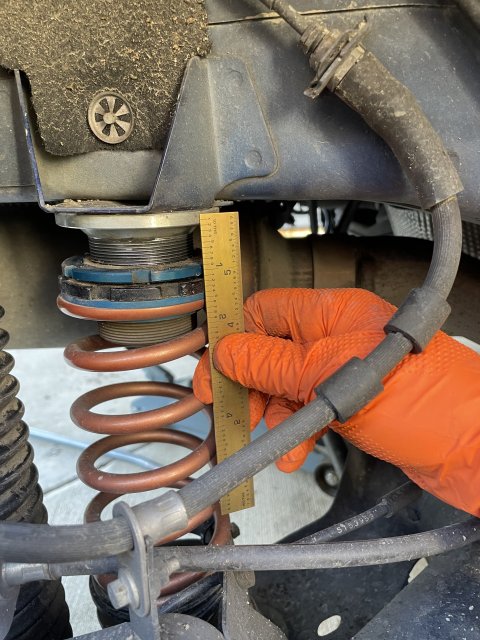

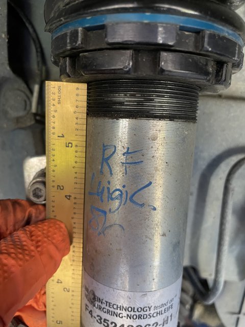

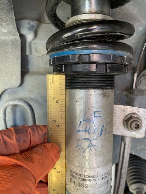

After driving the car around for a few months on the new suspension, the ride height settled out about 0.75” below stock height, with the adjusters almost bottomed out.
Took a few hours on a weekend to raise the adjusters up 0.5” per corner to sit just below stock height.
Also it’s been cold, rainy and I’ve been driving on dirty roads so plenty of gunk built up down there. Needs a wash. I’ve getting a funny spring clunk in the steering and occasional windup in the springs, probably to do with not having a real top bearing - the upper front perches are fixed and while I have swift spring couplers plus some thrust sheets up top, the lower perches is the just spring ion anodized aluminum which might be the source of the behavior. Now that I know I have 0.5” of downward adjustment, I may start thinking about some sort of more robust sealed needle bearing at the lower end.

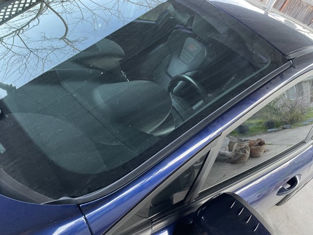

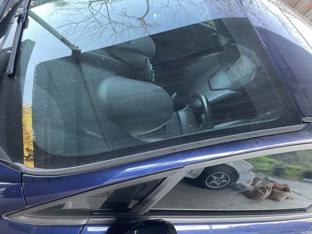

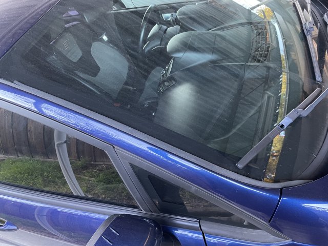

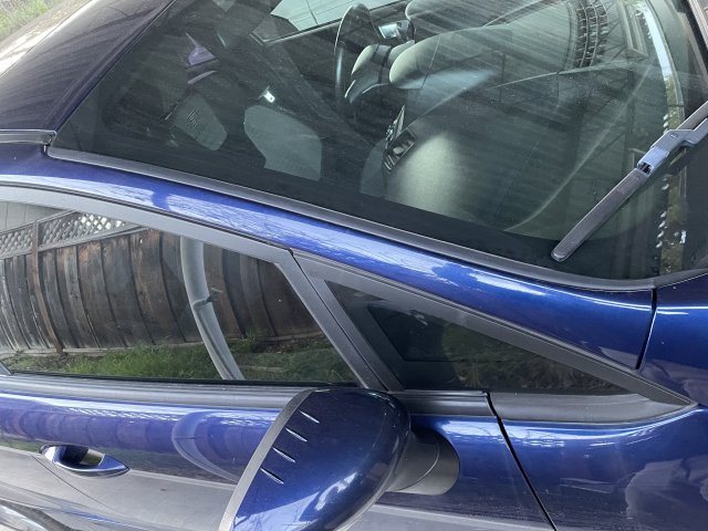

While I was at it I took the opportunity to replace my windshield trim that was decaying. One of them was literally falling apart in my hands trying to remove it. Took a week to get that crap out from under my fingernails 🤢

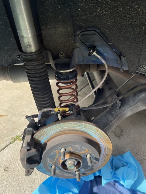

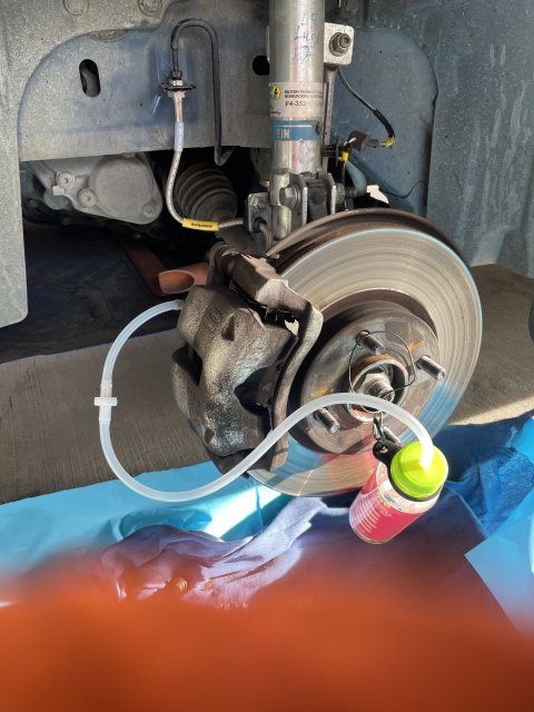

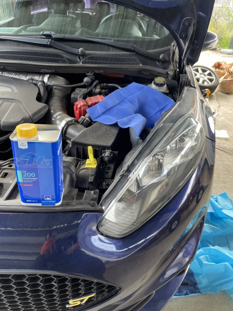

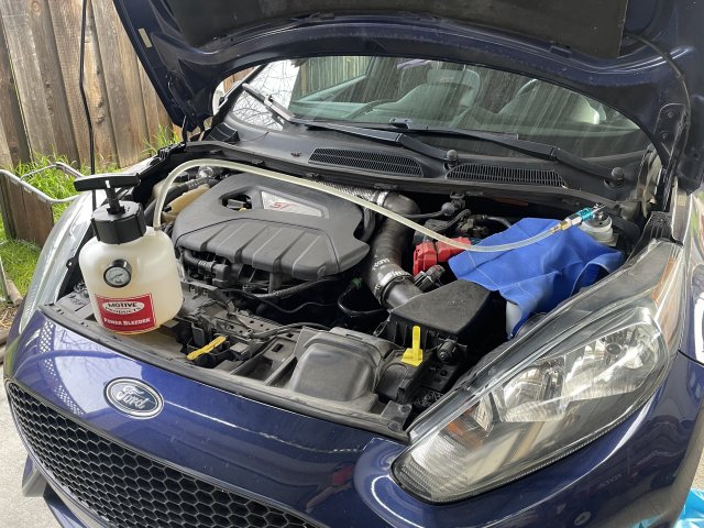

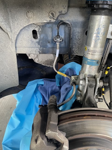

Got serious and finally did a brake (and clutch) flush with ATE200 brake fluid. Added stainless lines while I was at it. There's a slight difference, but very subtle and could just as well be the new fluid rather than the brake lines. Ran 2 whole liters of fluid through the system.
Ended up buying a power bleeder, and making 4 of my own brake bleeder bottles with 1/4" silicone tubing, some juice bottles from work, some cheap 1/4" PVDF check valves, and some silicone bottle clip rings I found on ebay, with a little wire to hang them. Ended up being a huge help since to do it right, you need to bleed with Forscan.
My neighbor gave me some surplus surgical drapes that I cut up and put to good use here to keep from spilling brake fluid everywhere.
Word for the wise, if you do a pretty thorough brake flush by cycling the ABS unit, hook the car battery on a charger. The ABS unit draws a ton of current, and if the accessory voltage Forscan is seeing drops below 10V, it aborts the test. I'm glad I had the check valves in the bleeders, as the last flush stopped in the middle!

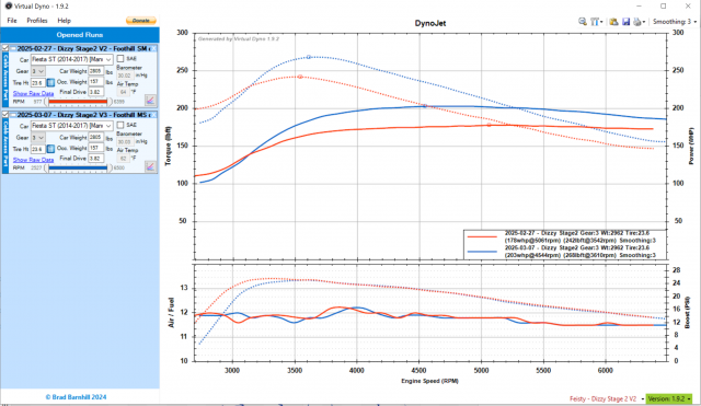

Also spent the $40 to upgrade my Dizzy Stage 2 tune from V2 to the new V3. It does feel like there's a little bit more grunt across the rev range. But the most immediate difference is a quality of life one. Jason did a really good job this time dialing the off-idle and on-off pedal transition. The previous tune was decent, but the car feels so much smoother without the tiny lurch when you go from throttle to coast, or get back on the throttle. Like butter.
Got out for a drive in the hills today and between the suspension adjustment and the new tune, it's starting to feel pretty awesome! Definitely happy about how the whole build has been turning out. Finally feel like I'm ready to sign up for a track day (change some more fluids - the Amsoil is finally getting close to the 25k mile mark).
The new tune also makes a better showing in V-Dyno. For some reason Jason's tunes previously always tested out low unless you get the car on a real dyno so the actual difference is smaller. I started adding TC Slip Actual to the datalog and it gives another obvious sign on whether you took a good datalog or not. Seems like a good run mostly stays below 2% slip. A bad run you'll see spikes >>2% Here's the new (V3) vs old (V2). These are not SAE corrected, though I do have the temp/pressure numbers. Similar conditions (a bit cold), and same stretch of road (although in opposite directions - the same direction data log had a big slip, so basically invalid.

Awesome to see. I loved Jason’s flash tunes when I was running the stock turbo and he tuned my big turbo like a champ as well.
