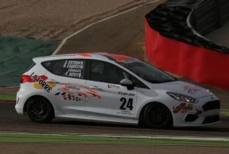

There are good examples you can google of non-aero fiestas in amateur racing series where you can see that all of them are superstiff/slammed cars. Two of them are Ford Fiesta Sprint Cup in the Netherlands and the Spanish Pura Pasion Fiesta Cup. See attached picture, copyright RR2 Motorsport

Ironically, that photograph appears to show a Fiesta in the middle of a left-hander with a wad of weight transferred to the outside wheels under a compliant suspension. I'd guess close to 40mm of difference between the front-left and -right corners. I'd also guess that team has lowered no farther than a level LCA to avoid positive camber.
Fortunately, we don't have to do too much research and experimentation to come to a pretty good outcome; there is a massive body of work that describes suspension best-practices.

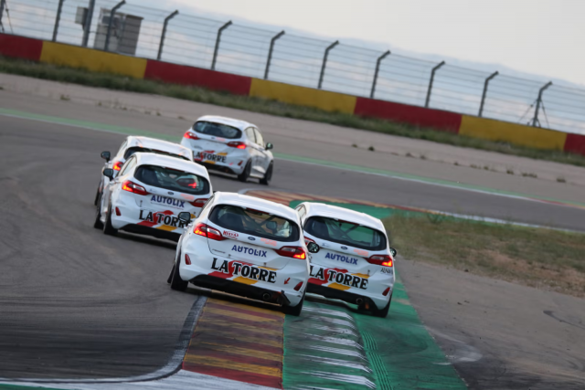

this one is better, you can also see the massive amount of static camber the last car has dialed in, with that amount of lowering it is hard to avoid positive camber gain and have a level LCA
But again the benefit of that low GC is what you want, even with a little positive camber gain, It directly determines the overall load transfer 30% lower GC means 30% less load transfer!
"with a wad of weight transferred to the outside wheels" <- this is also one of the important points: roll is not weight transfer, only because you see a car rolling, it does not mean necessarily it transfers a lot of weight, i know it is not easy but if you are interested and read a little about it it will make sense. Ofc the amount of roll you see also depends greatly on how fast the turn is.
copyright RR2 motorsport
The car in the back..., is broke. Look at the cars around it; nobody is running close to that amount of negative camber.
Weight transfer causes roll (and squat and dive). If the suspension is setup properly it can also increase total grip. F1 teams reduce anti-sway and increase negative camber at Monaco because they are down on aero-grid so they dial in more "mechanical" grip.

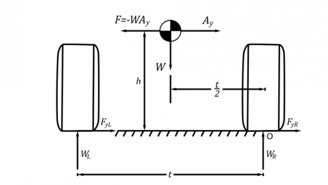

https://racingcardynamics.com/weight-transfer/
dW = W*Ay*h/t
dW = load transfer
W = weight
Ay = lateral acceleration
h = GC height
t = track width
one of the reasons for this is that the lever arm for that fromula above is NOT the distance between roll center and CG you describe (but it in reality it has some influence, see below), but the height of the GC h! It rly means, lower your CG by 50% -> decrease load transfer by 50%

The Milliken book i would rly like to read once in my life and i think there is a reason that the first third is about tires: they are the most important thing on a race car.
"Second, roll center is just as important as CG in determining load transfer." it is what many people think but I think it is not entirely true: Look at the simplified definition of overall lateral load transfer (independent of roll center), all of this is actually from the book you recommend, it is also well described here:
dW = W*Ay*h/t
dW = load transfer
W = weight
h = GC height
t = track width
You are right that roll center has a effect on load transfer, but I think more in a sense that you can balance the load transfer over the axles (this is also how race teams use anti-roll bars to set axle roll stiffness):
"when we increase front roll centre height, the lateral weight transfer decreases on the rear axle while increasing on the front. Conversely, if you increase rear roll centre height, lateral load transfer increases on the rear axle and decreases on the front axle"
To reduce overall load transfer of the car (this you want to increase overall grip) you have to lower CG!
But it is a little more complicated than the above formula, there are 3 components and if you look at the complete derivation roll center height has some effect on load transfer.
This considered, load transfer for an axle is (it is directly derived in the article linked above with an explanation of the parameters):
"In any case, do what you think is cool. More power to you. Just don’t mislead others with “advice” that you appear to have no actual grasp of, except “because racecar!!!”"
Yes! I 100% agree but I think I laid out a lot more arguments in this thread than just "because raceacar"
Milliken is a great book, but dense (that article is largely lifted from it), and no offense, but it appears you’ve read about a 1/4 way through the article and gotten bored and confused.
First, the straight up CG vs Track width “total lateral load transfer” is a simplified model that ignores suspension geometry and while it still has an effect on load transfer, it has little actual effect on when it comes to chassis setup. The more complex model gets broken down later in the article.
This is an artifact of simplifying from Milliken, which spends several chapters on multiple simple models of a vehicle, starting with a single wheel, then a two wheel bicycle, then a four wheel rigid vehicle, and finally a model that includes suspension geometry. It also derives cg and roll center as mathematical concepts, initially ignoring (but acknowledging later) that in an actual car at the final
chassis setup stage, cg and roll center cannot be changed independently.
The reason for this is that the initial assumptions are based around actually designing a suspension system from scratch, where cg and front+rear roll centers can be defined separately.
In the end, the roll component that is insignificant is from roll angle and the effect from gravity due to the CG being offset laterally from roll center. This establishes that “extreme body roll” in itself has very little effect on load transfer.
With suspension taken into account, The only portion of the car that behaves as you are assuming is the unsprung mass (wheels, tires and outer control arms/shocks/struts) which is a small component of the vehicle mass.
What’s described later is that in fact the “direct” or “kinematic” load transfer at each axle is defined by the distance from cg to roll axis, where roll axis is the line between front and rear roll centers.
The “it’s complicated” part comes in is that in moving roll center and cg at one end of the car by raising and lowering that axle has a compound effect on both axles of the car, the angle of the roll axis and that stiffness of one axle has an effect on load transfer at the other. It’s from this effect that we change understeer/oversteer dynamics.
In the end, on a street car that is past the design stage and has predetermined CG and suspension geometry, the total load transfer cannot be changed much at all, and changing CG height alone is fairly irrelevant when it comes to “tuning” the suspension.
