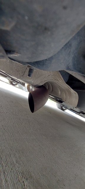

Well I have maxed out the stock fuel system on 93 and the whoosh v1. Next step is to obviously get a bigger intercooler and upgrade the fuel system. I have already purchased the larger intercooler, Jaguar injectors, and Jaguar HPFP. I will be test fitting the HPFP tomorrow evening and will keep everyone posted on the fitment. I have also installed a custom stealth side down exit 3" exhaust that is loud with plenty of pops, bangs, and burbles.
