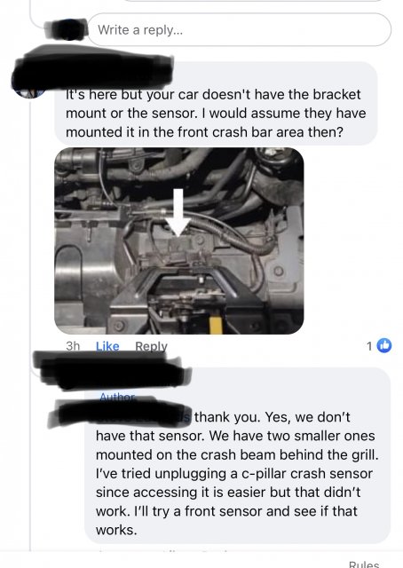

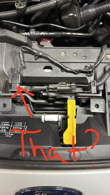

I posted in a UK track group on FB and one of the guys having the same problem suggested they unplug the hood latch sensor and it fixes this issue. I’m going to see if I can can hop on AMP this Friday and test. Ignore the red text.. That was me asking him to clarify which sensor they unplug.

Either the latch sensor or front crash sensor?
Some info here :
https://www.fiestastoc.com/threads/first-issue-on-track.289530/
The front crash sensors are inaccessible by simply opening the hood (or bonnet). That’s why I sent that pic to the guy who told me to unplug the sensor next to the hood latch to confirm that’s what they’re talking about and he said it was. It makes absolutely no since to me at all since it’s a hood latch sensor but it’s worth a shot. If it works, that means the RCM can remained plugged in and disable the fuel pumps in an actual crash.

Well, it’s definitely not the hood latch sensor. The UK cars have a single crash sensor in the middle behind the latch that they unplug to prevent the issue. I’ll try unplugging a front crash sensor but ours is likely embedded inside the RCM. 51E7D866-065C-4E5C-A559-0F129F9BC546.jpeg

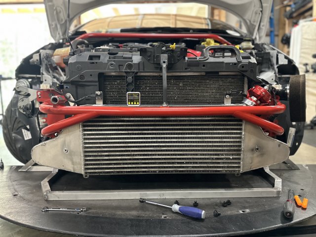

2E648A20-5614-47EF-BADC-B7F14AE8E2A3.jpeg Love the car too much to let it go so I’m gonna try to fix this.. I set the crash sensor mounting tabs on top of the DHM IC to exactly 90 degrees then set each sensor at 0 degrees parallel with the top of the intercooler. Both were off a few degrees in two directions so perhaps that’s just enough to make it have a false-crash detection. I could be 100% wrong.. We will find out. I’m still searching for a human who can access the RCM code too. Increasing the acceptable G and yaw values would be beneficial down the road. I have big plans for this car but need to get past this problem.
