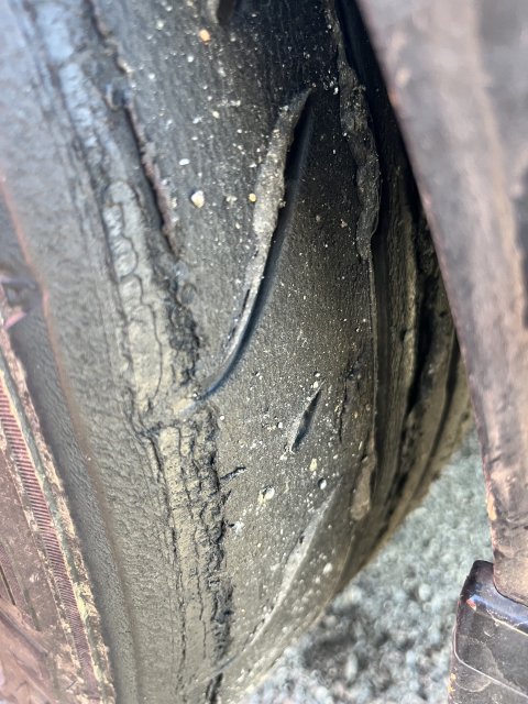

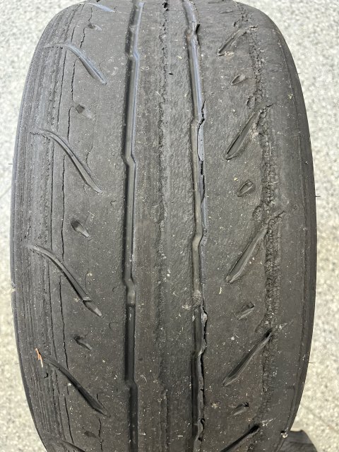

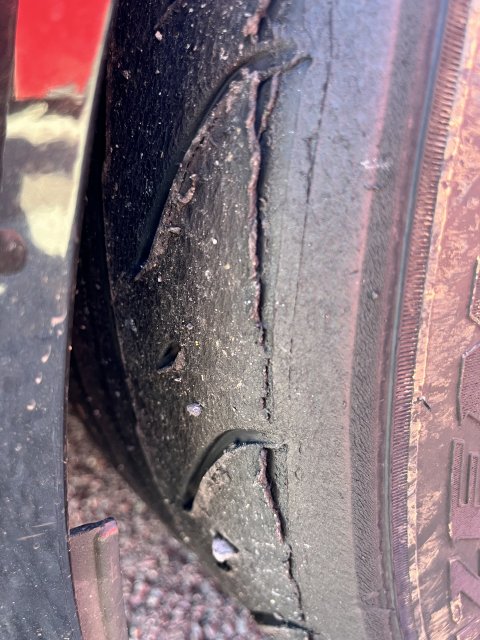

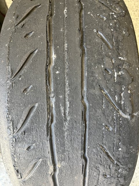

This is what I did to the RT660s last August. Front and rear. I’m sure there were tire pressure and driver mods to be had and make them work, but I chose just to go to Hoosier R7s instead. They have been fantastic.

@cidsamuth dayumn! That’s that’s the worst set I’ve ever seen. 😂 I’ve had pretty good luck but I do the “heat cycle then 24hr rest” thing with them. I almost bought a set of AR1s but decided to go with another set of RT660.
