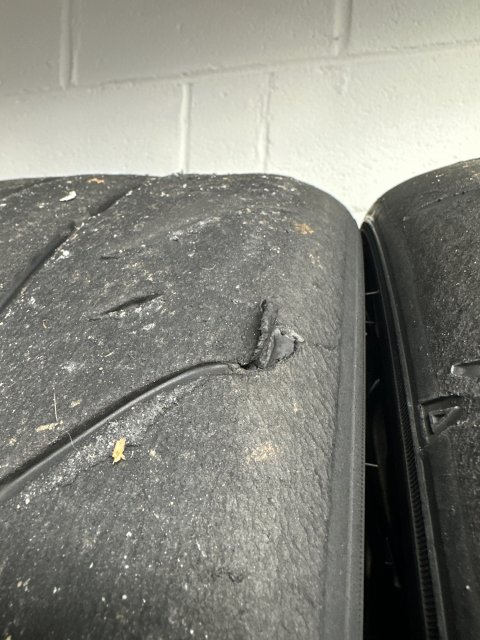

That’s the outside of the driver front. These tires had good tread left but they’re hard from too many heat cycles. I knew they’d suck but figured I’d keep tire’s consistent after making so many other changes. I assume the cut happened when I drifted into the curbing in T12 but it could’ve simply been fatigue. I’m picking up a Longacre pyrometer this week and will use it to get actual numbers after a hot lap so we can dial in pressure and camber trackside. It’s too bad adjusting camber on these cars is such a pain in the ass. Could be worse though..
