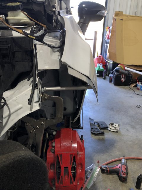

A buddy of mine did this before me and swore it helped but I was reluctant to agree and felt it wasn’t worth the effort. It does help (albeit minimal and at very fast speeds) so I’m glad I took 1/2 day and opened it up. A better mod if you haven’t done it is pulling the fenders out and mounting 225 or 235s.

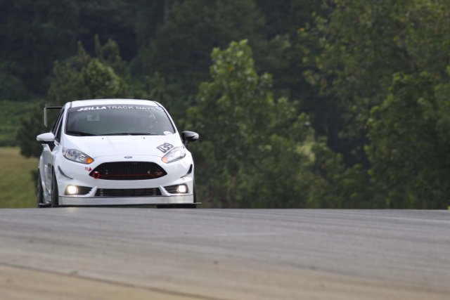

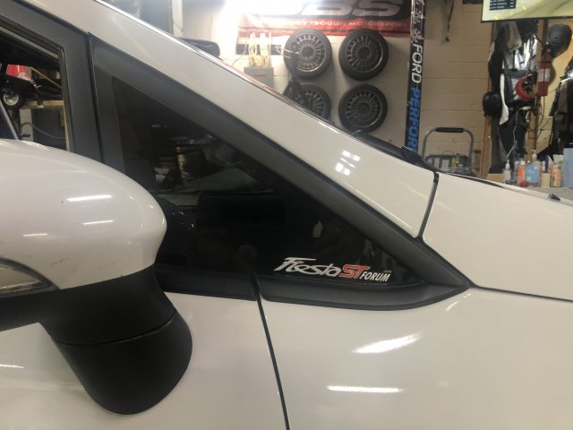

Great picture Mr. Woods, I'm a big fan of your build , quick question? Why your driver side mirror is black?
