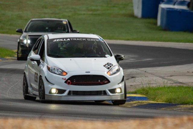

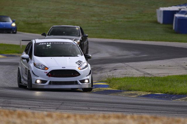

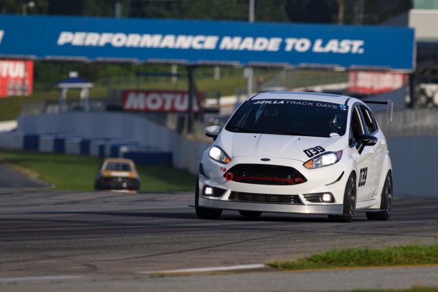

Car looks great, I’m interested to hear how it performs with all that meat on there.
There is a lot more grip, even with RT615K+. It’ll take some seat time for my balls to acclimate. I hope to be at VIR next week but there are a few things going on non-car related that I need to handle first. I’ll definitely be back at RA before the end of the season to retest with no bottom-out rubbing and lighter wheels. I finally remembered to charge my 10Hz GPS antenna so I could use TrackAddict last weekend. It’s the first time since last September that I’ve recorded lap data lol. My times were consistent but there’s a lot of room for improvement, whereas before I was at the car’s grip limit. Lap after lap the times were extremely close. The heavier wheels kept me from braking as late as I’m used too (which f’d me up) but the Rotas should remedy that. It was HOT last weekend too. I had zero grip problems after setting front hot temp to 33psi and rear hot temp to 30psi (I used to run 34psi hot square with 215 RT615K+). I also found adjusting my front suspension 3 clicks harder than the rear helped turn-in. It’s nice to be stiffer.
I suspect I’ll destroy my PB next trip. Humidity has dropped 40% in just one week! I just need to trust that the car can carry significantly more corner speed than I’m used too. It’ll come with more time. And THANK GOODNESS the crash sensors didn’t false positive again. I think that’s fixed now.

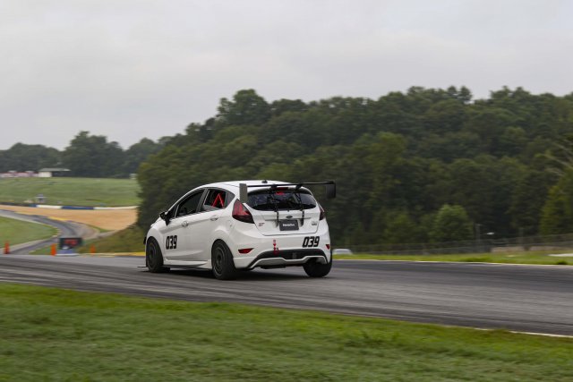

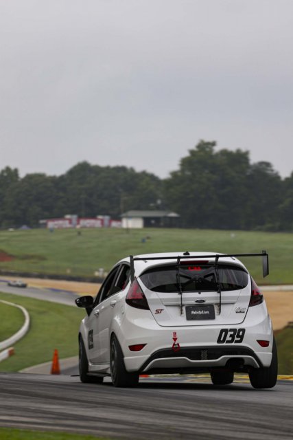

It may be unnecessary to shave the rear grill for a street car, but I do own a grinder so consider me inspired! :LOL:
Shaving the rear grill has been on my mind for a while, as it looks so cheesy when not actually functional. Does the rear grill become super flimsy after shaving it?
He hits 130+ mph on the track so I highly doubt it. It's on my to-do list as well.
