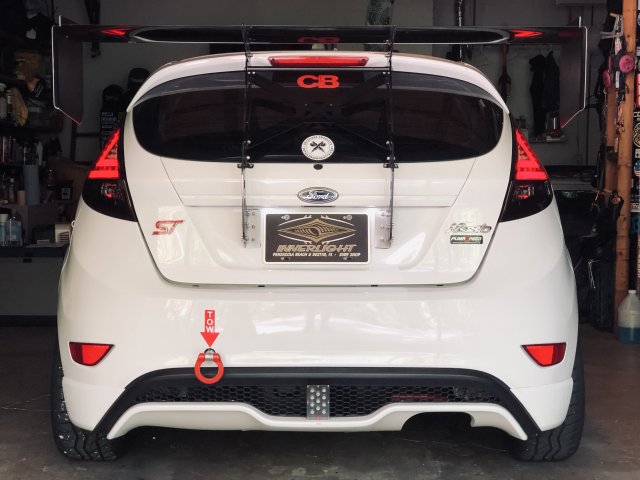

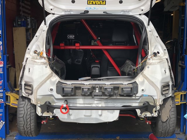

Removed the hitch, sanded the rear bumper grill, installed a steel crashbar and welded on a big ol’ nut for my second Cusco tow hook. That was a long day but it’s done!
