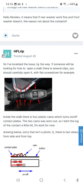

Just to update this thread. Instead of swapping the lines I found a post on the Mk7 Fiesta EcoBoost Owners Club FB group that explained the same issue that I was having and that the solution was to clean the contacts in the switch. So, with nothing to lose I tried that and it worked! I now have it all working just as it should.

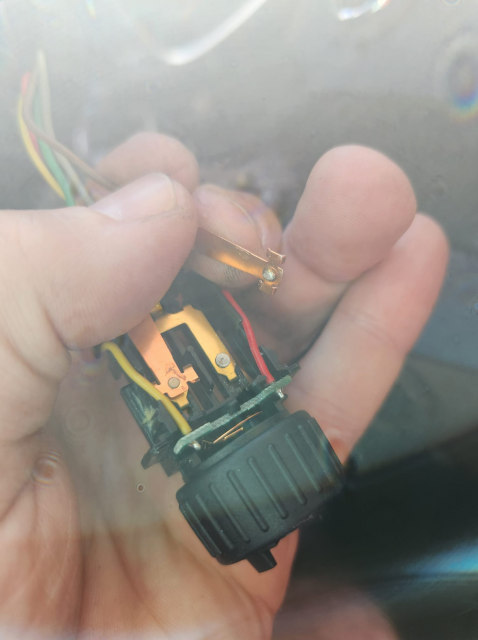

I have the same problem. The fuse have no problem. I disassembled the washer button and cleaned with sandpaper. The motor was tested with other 12V adapter and it works both way with polarity change. Multimeter showed the cabel has power but it does not work with a brand new pump as well. When I disconnect the pump the wipers run 3 times as normal and the rear wiper can do the same when I pull the button.
Anybody has any idea what can I do?
