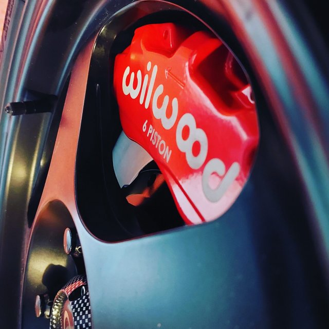

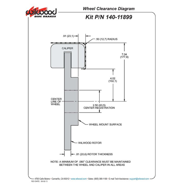

I’ve currently got the Revo Alcon big brake kit on the car which needs a spacer to fit. I’m looking to change the brakes so that I don’t need spacers and have been told that the Wilwood kit will fit.
I’m still undecided whether to go back to standard st brakes or fit the Wilwood kit.
My question is to everyone who’s had this kit fitted is what’s the performance like for fast road use and with them being a lot lighter, is this noticeable when driving?
