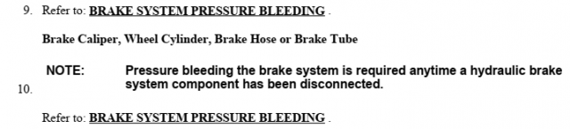

Here is what the service manual says.
  1. NOTE: The HCU bleeding procedure is necessary if the HCU or any components upstream of the HCU are installed new.
Do we consider the brake master "upstream" of the HCU?
I do not think the calipers are "upstream" of the HCU though
Its also stated as items 18 and 19 of the Brake System Pressure Bleeding procedure. Although they do state HCU replacement in bold at steps 18 and 19 in the bleed procedure.
Warranty time is 1.2hrs(for caliper replacement) which would indicate it includes more than just a regular bleed. This is obviously only for warranty purposes.
Here is what it states for Master Cylinder replacement which alludes that you reference the full 1-19 step system bleed which includes the ABS service bleed. This is also stated under caliper replacement.
And if anyone wants to know where air gets trapped.... Right as the lines come up and out of the ABS HCU(in blue).
Again, this is for by the book workshop manual steps and does not indicate what others have tried and completed without the ABS bleed.
