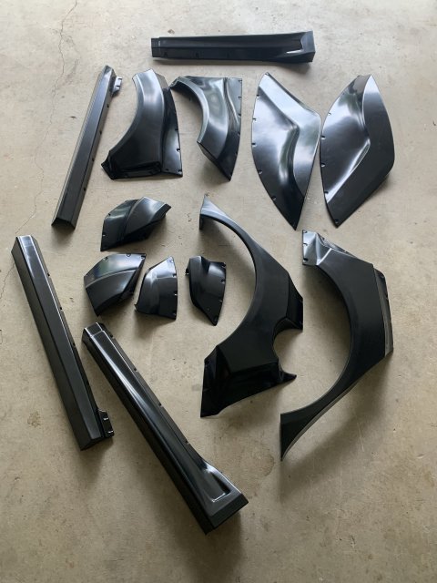

You will definitely need spacers or new wheels. The Carbon Pixels kit looks a bit wider than the flares I used to run, and I was rocking 2.5" wheel spacers.

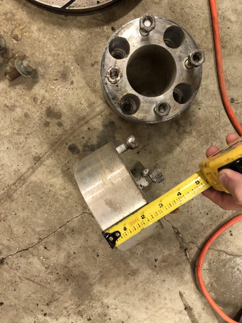

Using spacers this big is generally not advised, especially for daily drivers, because one big pothole could ruin your day (and car).

(Example of big Ol' wheel spacers... less than good idea!)

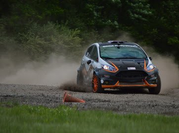

(Example of Fiesta running baby flares and sketchy wheel spacers doing sketchy things)
EDIT: You also mention "Running a lot of spacers to get the correct fitment"... I would just like to note that you absolutely CANNOT stack spacers on top of each other. (At least if you value your life and vehicle lol)
