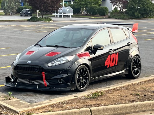

I used M2. They give about 1” more room, assuming you cut the fenders underneath. They are pricey, but fit well.
The negative is that the finish is so-so. It is fine for my track car with just a rattle can topping, but they would need some sanding and finishing for a nice street car.
Also remember, with more offset to fill those fenders comes more torque steer and more tramlining.
Here is a pic with the M2 flares and +27 offset 17x8 rims (Hoosier tires).
That looks awesome. How wide of a tire can you fit in there?
Right now, I’m running Hoosier R7s, 225/40/17. They have a 9.6” section width. The rims are +27. It’s tight getting it in there and not rub the flare on the outside and the coilover on the inside under track conditions.
I have removed most of the wheel liners and “clearanced” the wheel well underneath with a hammer.
