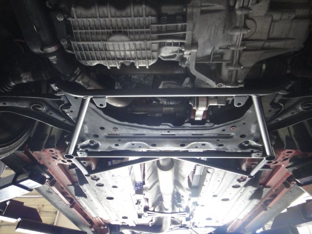

I can attest to the gains from the Pierce 6 point brace. Tested it on worn out tires and it gave grip again. Not sure if I could give that up :( Even tightened up rattles and shimmies. Maybe someday there will be one that works with that brace.
I too ran into this problem, this is why I added the tabs to my 6-PT brace.
However, I never finished the project.
14,460
7,011
#25
Fair enough, but I could not use them, and still use this car the way I do, so it's a moot point for me anyway.

I will say that the brace has made the car unable to go over speed bumps like I normally would. I have to go slow now and that's on stock ride height. This pretty much makes lowering the car out of the question. Although I didnt want to lower it because the underside of lowered cars always gets thrashed it would've been nice to have the option since I'm going coilovers sometime soon. (If K-Sport would get their $hit together with their manufacturing been waiting over 2 months for delivery)

Just a heads up.. You can run chassis splitters and belly pans with braces. You’ll just have to build or modify them yourselves. 😉 I REALLY miss my Piece 6 point. I’m actually in the process of designing braces that link the front to the back (like everyone else’s) but they’ll have riv nuts for mounting the splitter, pan and diffuser. I suppose you could build something similar for rally use but I’m not sure those guys want the chassis to be as stiff as road cars need to be.
14,460
7,011
#34

Yeah I’m sure they have it figured out. There’s a big difference in turn-in feel with and without the Pierce 6 point, even with a roll bar and traction bar. That’s what I was referring too. Bracing the subframe to the unibody makes massive difference in the way this car handles on pavement.
Put me on the list as a customer if you want to make a few bucks. I'll for sure take a set off your hands!
I noticed the same exact thing. The turn in and grip on turns and a straight line, and the shakes and shimmies and the torque steel all taken care of with the pierce 6pt brace.
