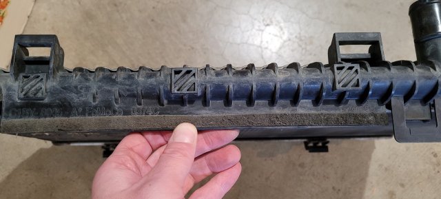

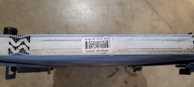

Anyone have an OEM Fiesta radiator laying around that can look and see if there are any markings that suggest who makes it? Is it Denso, Visteon, Valeo, etc?

I don't see any indication of where it was made, but here are photos of everything I can find on my '14 radiator.
