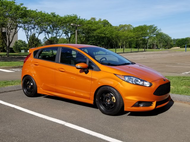

Lighter is nice, and 16 inch gives you some options depending on how you want to go - like 205/50-16 looks good with stock suspension. You might find more info in other sub groups, since we kill our sticky tires on the track, road use just seems to even them out a little!

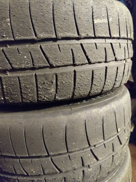

My track setup is 215/45/16 BF Goodrich Rival S 1.5 on 16x8 bronze Koenig Dekagrams. Absolutely love the Rivals, performance for me has been just as good as the RE71R but the longevity is crazy, this is them after 4 full track days, probably gonna get 2 more out of them. IMG_20220513_221751.jpg

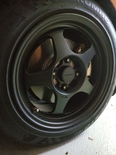

15x7.5 slips and a 205/50 is a great combo. Miata size tires and 11lbs lighter than stock according to my shipping scale. I have Kumho PS31 tires on here and they're great summer daily tires. Not a hardcore track tire, I'd autox on them though

oh and you do need a small spacer in the rear if you want to run center caps. hub lip sticks out too far. I have 5mm but you may be able to get away with 3
