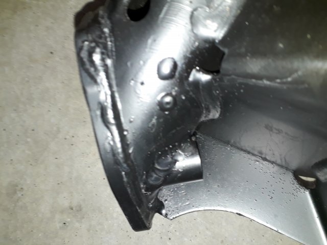

My plan is to change the set-up completely. My 2015 ST has the useful set-up for fast and flat circuits and not for normal and bumpy roads.
First of all I disconnected one stabilizer link, so the stabilizer bar is not working any more. It makes the front of the car more calm.

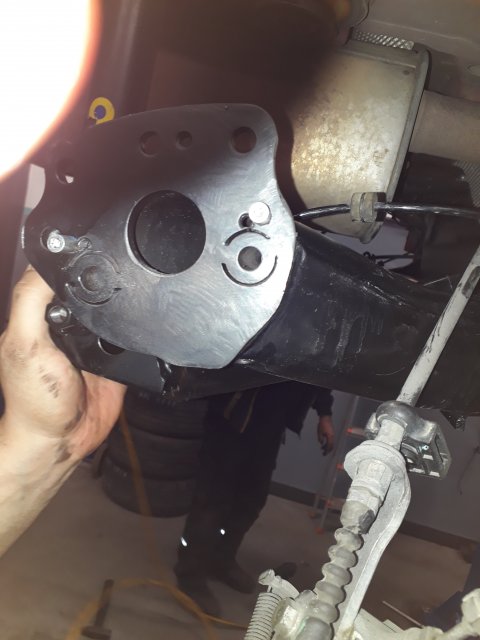

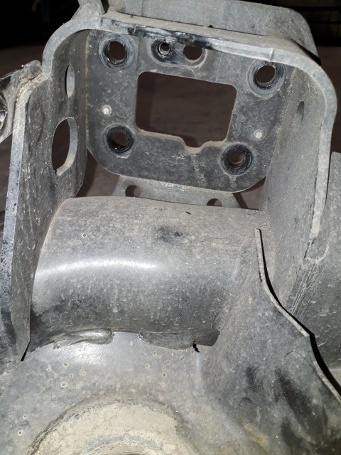

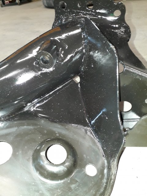

Then I adapted the nonST softer rear beam to make the car more stable under heavy braking and not to have so much oversteer when going off gas.

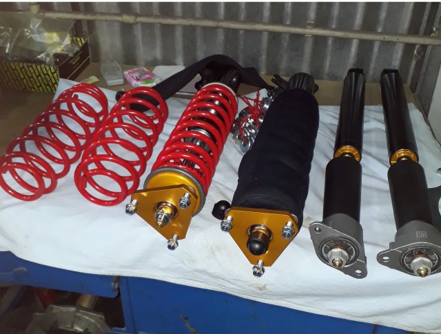

Next was the order of the custom springs and shocks.
Adapted rear beam see photos:

On normal bumpy roads I am more in the air than on the road and driving even when I want to go straight on.
When I go fast, of course...
When I go slow, is the set-up just unnecessary uncomfortable.
Spring rates are 30 kg/cm in front and 23 kg/cm in the rear.
Shock absorbers compression / rebound (measured at 100 RPM and 100 mm stroke) are:
Front 1100 / 1800 N
Rear 900/ 900 N
I have ordered set-up which works on normal roads.
Rallye set-up instead of racing set-up.
In one month about I will see, if the company did the job well.
