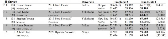

Yes, its a guestimate based on my experience with various tires and suspension setups. Without individual testing on every setup combination there is no way to be completely accurate. I assume everyone reading my statement would understand that.
I was trying to think of a good direct comparison. The best I can come up with is the Vegas Tour in April. Rob Kridder was there running his full FiST. If you dont know Rob, here is some info on him: Rob Krider – DNN MOTORSPORTS (wordpress.com)
At the end of last year after Nationals was canceled, he made a last minute decision to go to the RallyCross Nationals which meant taking off his $5k double adjustable MSC suspension setup and putting on stock. In his very first RallyCross event, he ended up working his way back up to 3rd overall (after getting into a hole day 1).
Fast Forward, Vegas Tour race, he said he had gotten the rear MSC shocks back on, but didnt have time to put the fronts on. He runs A052s, because in his testing (read articles on Ford Muscle The Way of the FiST: The SCCA RallyCross National Championships (fordmuscle.com) ), and obviously he hates money.
So this is about the best comparison I have, a very good driver, on same/better tires (A052vRT660). Day 1 I got 2 seconds on him, Day 2, 1 second. Draw your own conclusions, but proper shocks/sway does matter. 2021 Vegas class results.jpg

My point was that one does not need shocks or a swaybar to be competitive in the class.
