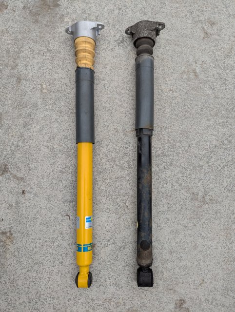

Yesterday I did Bilstein B6 struts, new oem coils, new rear hubs and bearings, new set of Continental Viking Contacts, and Ravenol transmission fluid. Took all day because of battling rust but I only had to cut one bolt. I have a whole set of Vibra-Technic motor mounts waiting to install, but I've had enough of working on the car for a bit. I'll do them within the next month.
Bilstein's feel great. Hopefully they settle in over time because they're slightly bouncy, but they feel way better than my worn out struts obviously. The transmission fluid is the most impactful mod I've ever done to this car. Night and day difference. Shifting is much more smooth and doesn't buck anymore when shifting fast from 2nd to 3rd. PXL_20241127_232613251.jpg PXL_20241127_161202149.jpg PXL_20241127_181205447.jpg

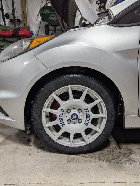

If you find some time, post some pics of from the side showing wheel gap. Always trying to get a better idea of how B6 sit

Here you go. Not the best pictures since it gets dark at 5pm. Ignore my finger in the picture. Looks nearly identical to stock height. Currently on 195/50-16 Continental VikingContact 7 winter tires.
PXL_20241202_221437622.jpg PXL_20241202_221457895.jpg PXL_20241202_221509026.jpg

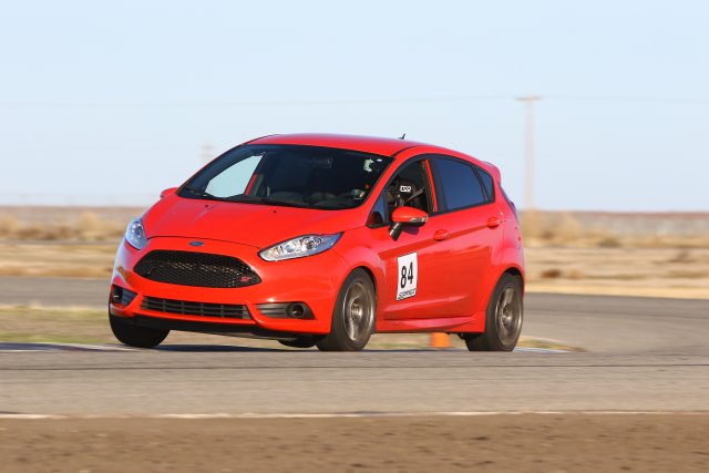

How is the new suspension setup on track?
I’ll elaborate further in the thread but it performs and is competitive with much stiffer coilover setups on track. I am going to install some stickier “lap time” tires before the next event. The tires I used this weekend are the tires I planned to use with the stock ‘15 springs on track, so now that I have more spring rate, I think a better tire is now warranted.
Ran 215/45/16 Falken 615k+ this weekend.
Going to install 205/45/16 Falken RT660 as an fyi

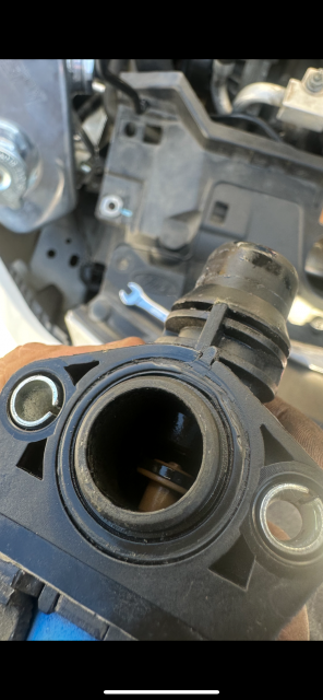

Was chasing a coolant leak for a month now that I thought was coming from the bypass valve. I wasn’t sure so I bought a thermostat housing as a precaution and a new bypass valve as the seal for the valve was $40 by itself and $100 for a new valve. Also don’t mind some preventative maintenance. Also the new OEM thermostat housing that I purchased off rock auto comes with a 180 degree thermostat. There is a 82 degrees celsius stamped on the back of the thermostat. I didn’t know this as a purchased the 180 off whoosh because I thought it would come with a 207 degree one. Anyways that seal is done. Bled all the air and it’s good to go now.
