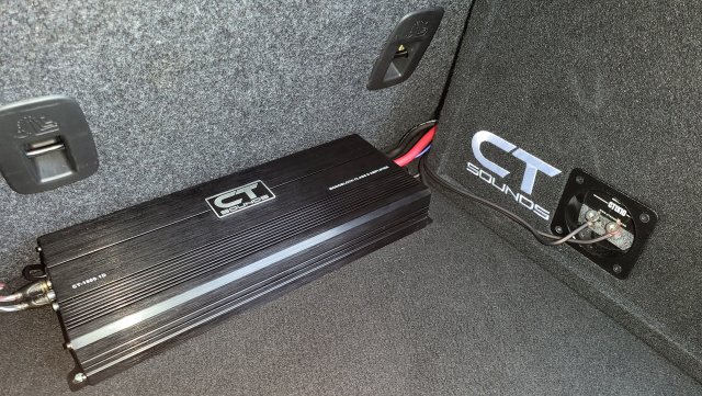

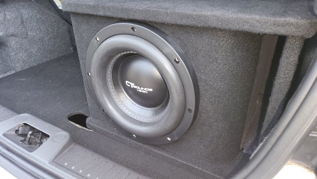

Also, didn't take any pictures but updated my component speakers and tweeters with some Ct Sounds to level out the sub in the boot. Night and day.

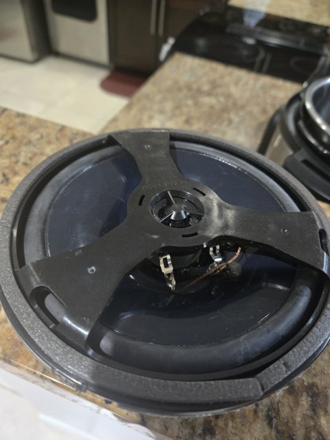

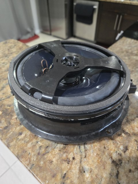

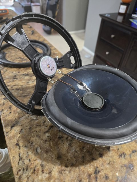

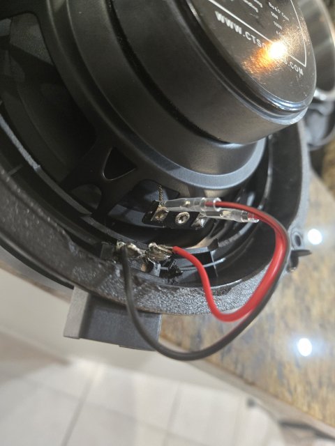

Hey, so I knew going into it that I would be re-using the factory speaker mounts so I pulled those and ripped out the old speakers. Used a drimel to cut out the speaker cage. Swapped my speakers in and then soldered the lines the same way the previous speaker was.
Tweeters different story, literally nothing online for them so I pulled the tweeters and removed back portion which had the adapter and stock plug. I soldered the new tweeter ends onto the leads and it ended up working lol. No real science here just a bit of common sense really. Got the rears next up, going to dynamat everything so I'll take pictures then and post. If you have any questions lmk.
