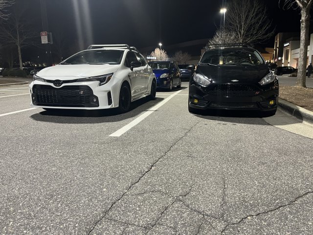

At first glance, for that front shot, I thought that was one of the TRD(?) version CAMRYS, that's how huge that car appears to me!
Yeah, way way too big a ride for me, and NO THANKS as for that price I will stay with what I have, since they flat out refuse to bring the Yaris version here. [mad] [thumbdown]

It honestly wasn’t as big as I was expecting, but I totally agree with you on the Yaris being the one I really want. Of course the Yaris would probably suffer from the dealer markup like the Corolla does.

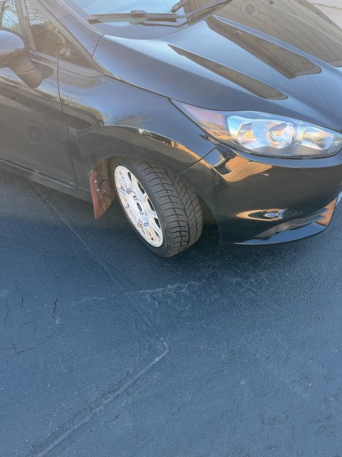

Motorcycle getting new tires, spent the week riding the FiestaST on a bed of road salt.
Rained this morning so spent part of it washing the white carcinogen off.

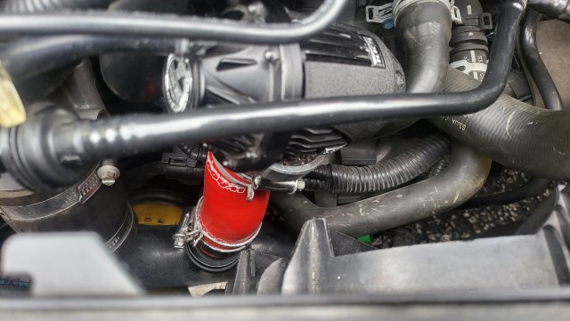

I'm not familiar with that. What benefit does it give over the symposer delete kit?
It Is for my BOV that comes directly off the charge pipe where symposer port is. The hose itself is a direct replacement for the factory hose that the symposer is attached to, or your symposer delete kit which I previously had. It's a much better hose and after ripping mine out a few times it got tore up pretty badly, I was actually venting at really low RPM before this hose.

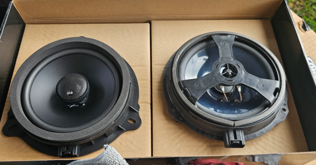

Installed brand new plug and play OEM replacement PB speakers and tweeter
They sound alot better than stock, more clear and have more bass compared to oem
Bought from Crutchfield
Front: PowerBass OE65C-FD
Rear: PowerBass OE652-FD
thanks for the info, need to put these on my wishlist. How old are the ones on the right and how long did installation take?

How was the tweeter install? Alot of them arent PNP and need to be fitted/massaged>
felopr
821
373
JD
The tweeter its in the socket held by 3 clips, pry loosen the clips while pushing the tweeter out until its out,
The tweeter have some tabs for orientation, notice how they go into the socket
Grab the new tweeter, aling with the orientation on the socket, push in until you hear the click from the clips, done
Check the old tweeter on the backside, one side of the cable socket has like resistor, one side doesnt. While installing the supplied cable socket on the new tweeter, the tweeter cables, one have a resistor on one cable, the other cable doesn't. Align the resistor with the socket like on the old tweeter, push the socket into the cables. Done, plug and play, no splice required

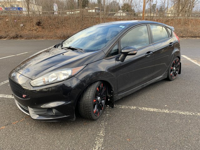

Fixed the hanging side skirts and slapped on those Rally Armor red on black mud flaps. Next will probably be some more red trim in a couple areas then onto a motor mount with the Accessport!
