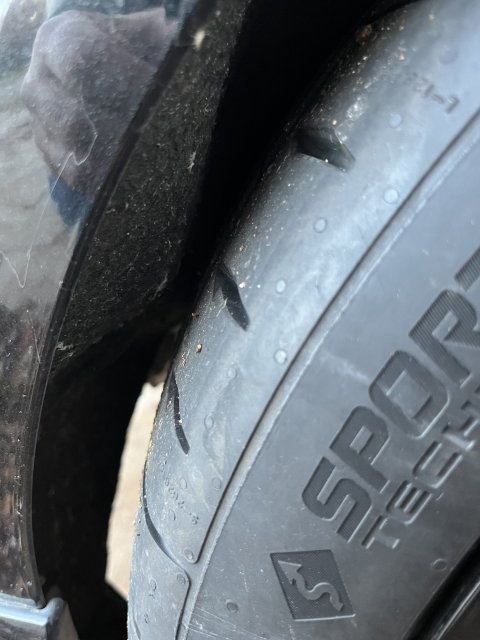

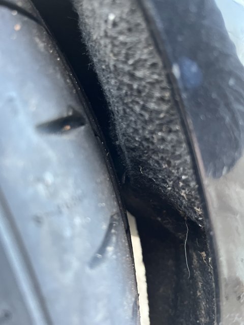

A little on the driver side rear. Looks like there’s a bit of slack in the felt-like panel.
As you mentioned, looks like the felt is sagging. Next time you have the wheel off it’s worth taking a look if one of the push fasteners holding the felt on is loose or missing
I noticed the same issue on mine and all of the fasteners are securely in. Seems like a design deficiency.

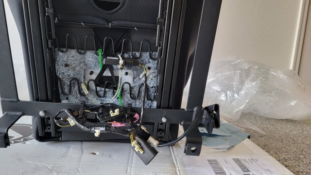

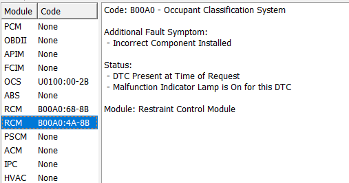

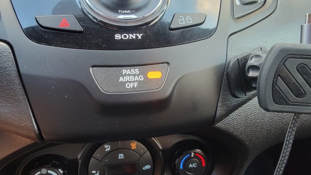

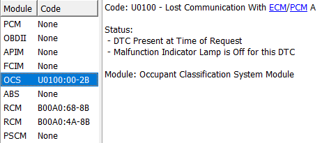

This is an update to the passenger seat occupancy sensor part 1 from other day.
Ecosport's occupancy classification sensor looks physically identical to Fiesta's with only difference being the part number on the label. However, plugging it in and turning the car on results in RCM throwing "Incorrect Component Installed", followed by OCSM throwing "Lost Communication with ECM/PCM A" error.
As a follow on test, I moved the bag from Ecosport's sensor to Fiesta's and did not end up with any low fluid errors. For the next step, I connected passenger seatbelt to its buckle to simulate someone occupying the passenger seat. "PASS AIRBAG OFF" light came on with nothing or a light object on the bag. Light turned off when I set on the bag, so it appears that Ecosport bag works fine with Fiesta's OCSM.
I installed the bag bottom of a Corbeau Forza seat. Sides fit snugly, so I only needed a couple of zip ties to prevent it from moving forward or backward. I ran the above test again after installing the seat and it still worked as expected. Cost of both used Fiesta OCSM and used Ecosport OCSM + Bag end up being about half of a new Fiesta OCSM + Bag, so I'm still happy with the result.

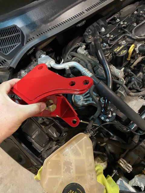

Finally installed my AWR 70 durometer PMM. Goodbye passenger shift sounds. Shifting feel once again has improved to where I would recommend this upgrade to anyone. NVH increase is minimal. AWR makes great products; I’d recommend them to anyone.
Install was pretty easy apart from fitment since I was doing this myself.
Still waiting on an ITG filter from Whoosh, postal service once again living up to it’s reputation.
I realized with my plugs from Whoosh I stopped getting so much negative correction- I now bet the old NGK plugs I bought on Amazon were counterfeits. Lesson learned!

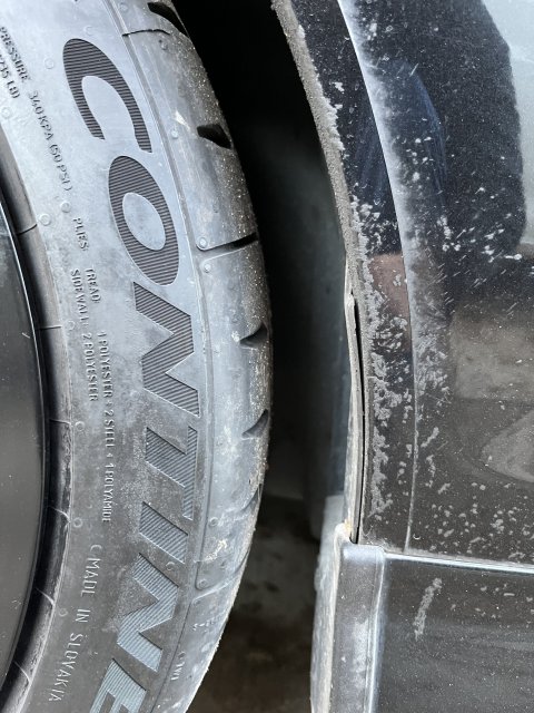

One that just happens to sell liners. I thought the dealership did this after "service" but was apparently coincidence. Rubbed through, replaced mine earlier this year as it helps limit road-salt exposure for the strut tower structures. I think this would've happened with stock size too; not just the Continental 215/45R17 I've been running through the Winters.
