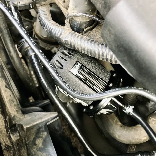

Got the HKS SSQV blow off valve installed finally! The removal of the stock BOV and then install of the block off plate was crazy easy with a 12 inch extension > swivel adapter > 5mm allen head. Raised the front, took the wheel off, and you could just work it in no problem.
The symposer was a huge pain in the ass to remove. Was working in the parking lot and had a neighbor randomly come out and provide some much needed extra hands and help. I liked the symposer noise but sort of hated the ear fatigue and competing frequencies in the 2800-3300 RPM range. Totally cleaned that up but you do loose that little bit of growl. Overall worth it.
My snap ring wasn't quite installed correctly so on my first full boost pull the whole thing came out of the adapter. Drove home, re-installed, all good now!
The sound is WEIRD. I love it though. I'll have to try the other insert I have as well. Can get all kinds of squacks, whooshes, and stu-tu-tu as you want it. I'm sure not everyone is driving around playing their car and mods like an instrument but I just can't help myself. The way it holds and vents feels really good, to the point the gas pedal is just feeling more rigid and responsive. Very happy I went this route though I want to try the Turbosmart full recirc as well. I love the way that setup sounds too.

Can’t go wrong with the HKS! Symposer location makes cleaning it so much easier too.
Right? Maintenance and general inspection seems about a million times easier. And just getting rid of the heat soak from a component being turbo-mounted makes me feel a lot better. The flex of the factory piping up to the BOV feels a little meh and it really sits against a couple of other lines but honestly I feel like it’s the best configuration. Paired with an open-ish intake on the same side it really just creates a fun auditory experience though. I’ve probably put 50-60 miles on the ST today.

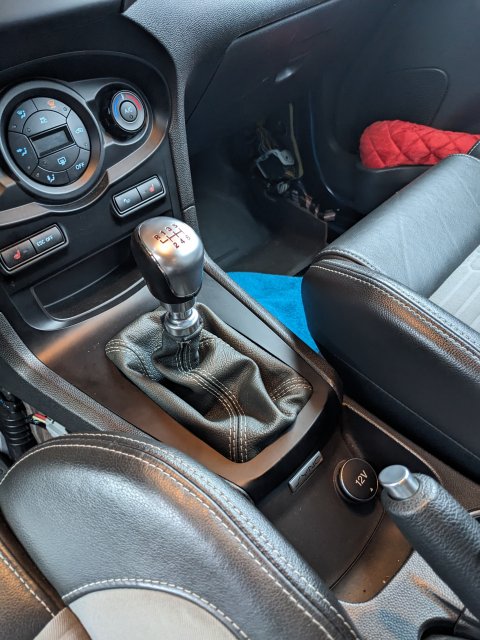

Added a Redline goods shift boot, as the stocker was developing holes. Center arm rest with padding coming soon (I need spray adhesive):
I used Jeff's method and stuck it on and over the oem material and used duct tape to hold it (under the screw on portion). Cant see any of the tape.
Its not the gray or green plastic type duck tape rather a malleable aluminum material for doing say HVAC ducts. Anyhow super simple, tight and 100% reversible.
