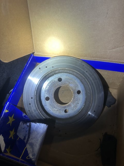

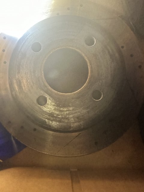

I racked the ST up and I noticed when I spin the left rear tire it has more resistance than the right rear. I there is no noise and no drag. I got home and touched the rotors and the left rear was definitely hotter than the other side. So I took a look at the old rotors. The slots are completely gone on the backside. I Believe it was the left rear. My dumb self can’t remember. I didn’t even bother to look as it started to rain/snow so I tried to get out of there. Does this mean the caliper is sticking? The pads on both sides seemed to be worn evenly. Maybe 5 mm of life left on all pads. Slide pins had a nice coat of grease on them when they were removed.
When screwing the Caliper piston back into its bore...make sure that it gives minimal resistance as its is placed back into its home. And that the Caliper piston is keyed correctly to the brake pads also. I showed this in a DIY with EBC pads and rotors replacement.

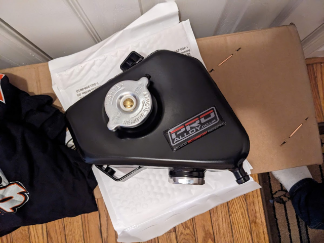

This beautiful piece came in the mail today. Gonna try and get it installed this weekend after work tomorrow. Assuming I don't brake any of my coolant lines it should be a simple install. also got a replacement OEM crash bar so I can sacrifice the piece that mounts to the core support for the BA intercooler install. Might see about installing the radiator and crash bar this weekend too.

Got my coolant tank in the mail today. Excited to get it installed this weekend. Heres to hoping I dont have any coolant lines brake on me. I got lucky installing my downpipe and ended up not breaking any of the downpipe bolts to the turbo so will I get lucky again this time. I guess well have to see. I did a Mishimoto coolant tank on the Mustang so this is a warm welcome of an upgrade to the Fiesta.
