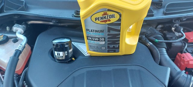

Changed the oil prior to garaging for winter. Went with Pennzoil Ultra Plat this time. Emptied the Damond OCC maybe a teaspoon of oil came out. Only managed to put 900ish miles since my last change (not many miles this year).

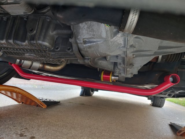

Took over 4 weeks but the Trac Bar finally got here. The OEM bolts were so tight, that I have to wonder why they give any sort of torquing instructions, just make them as tight as possible. I also discovered that I had no 18mm sockets which was very annoying. The socket set I got from Harbor Freight went from 17mm to 21mm. Had to make a special trip Northern Tool just for this one item.

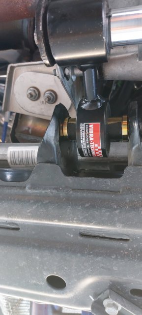

Oil and filter change, brake fluid change and installed a Vibra-Technics rear motor mount. The motor mount is replacing a whoosh unit like others I believe a polyurethane rear motor mount is not a good idea on this car due to the heat.
The brake fluid from the front calipers was much much darker than the rear. I will be running a another bottle through at some point.

What's your opinion on the added NVH with vibra, if any?

I don't feel like I can give it a fair review due to the fact I have a upgraded passenger side motor mount. With that said I know others who have installed this mount with no other upgraded mounts and have been very happy with it.

There's always a break-in period with any new mount.
You find what works for your style.
I'm happy with what I got. I don't drive it hard, but I do drive it fast.
It's so good at fast.

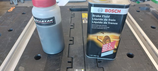

Same brake fluid I have and will use for the brakes AND the clutch whenever I get around to it.
It is about as good as it gets for a DOT 4 LV fluid, as far as boiling points/specs/etc. goes. [thumb]
If that is the 'fast road' VT mount, I've had mine on the car for about 2+ years now. It is damn near perfect as far as I'm concerned. [wink]
