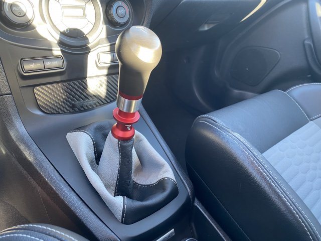

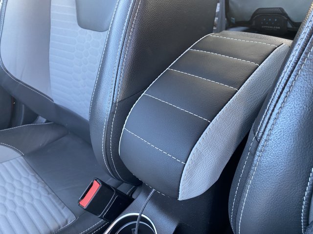

Finally got around to installing the redline goods armrest cover and shift boot. Topped off with a Raceseng lockout and knob.
Looks great!
Any advice you can give on the lockout collar? I feel like I'm over-complicating attaching the boot to the collar and apparently when I last did mine, I didn't install it well enough to the point my boot just popped out of the collar recently. :/

Looks great!
I had that same problem with a raceng….but, upon investigation it was clear the the collar was milled to much tighter spec than that black plastic tongue thing…a little filing and snapped right in.
