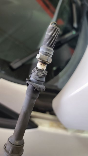

I suspect that all the times I didn't let the car properly warm up allowed a bunch of preignition to happen. The preignition then just widened the gap on the plugs and it started to short. Causing it to get hotter and hotter. Melting the insulation. Then *PLOOF* it fails. To be honest I'm not really sure. This is the first time it's ever happened to me on any car. I'm keeping an eye on it. Lesson learned I guess?
All the other plugs had wider gaps then when I put them in initially. I'm using step colder NGK's because tune.

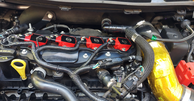

Really interested in how much of a difference (measured) these make.
Hell, I wasn’t aware anyone made an aftermarket coil.
Due to my setup, I should be able to tell the difference if there is one (and there should be although I won't be measuring anything since I have no base to compare to). Most differences for coils isn't necessarily power but instead how smoothly the power is delivered upon acceleration at different rpm points. Typically there is also a bit better idle. I will be driving quite a bit over the weekend so I can test thoroughly and give my thoughts.

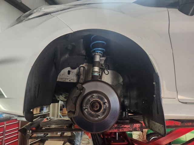

Put on some used Bilsteins B14's. They seem to be in fairly good condition. I had to raise them to 5he top of the adjusters to keep them from rubbinng with my 205/45r17 continental contact sports. I think original owner had them set to be flush with stock sidewall height. The lowlight picture was me just installing with out adjusting them up. About a quarter inch of the tire was tucked.

Pumaspeed coils are in so we shall see...
I installed Swann ignition coils and they increased the power across the whole rev range, more responsive and uses less fuel and runs smoother. The old factory ones had over 110000km on them.. Was either them or some really expensive ones from overseas somewhere.
